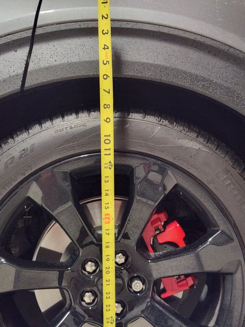

Making a slightly duplicate post here (original was over the the WHYDTYET thread) with more detail. I wound up going with Eibach for springs.
First impressions (these were installed yesterday):
- One of my concerns was that I would need spacers to keep my wheels from looking sunk into the wheel wells. Also that the wells were too wide at the bottom and the wheels/tires would look undersized. Both of these were unfounded. I think it looks fine.
- Was also concerned that it would be too low on the wheels/tires. I do need this thing to act like an SUV every once in a while. I don't think these are too low for my needs or looks preferences.
- Getting in and out of the car is much easier/more comfortable. I've got little kids, so I expect this to make a big difference for them too.
- I'm tall, so I can now see over the vehicle a good bit. This is nice. However, it's not so low that I have comfort issues with the liftgate being too low.
- Initial driving impressions are that it feels a lot like the stock setup, just lower (duh), but I really haven't done much on them yet. I should get some decent highway time this week and will try to find some crooked roads to twist up if I can. Dealing with Louisiana's trash road conditions was another one of my concerns and so far not an issue. They are definitely stiffer, but I don't feel like I'm getting beat up.
The pictures don't really do it justice as the in person experience is a lot different than before installation. Here you go anyway though...
Before:
Front:
Rear:
After:
Front:
Rear:
Super scientific, I know.
Anyway, I'm very happy with them out of the gate. This is the first car I've ever done any suspension mods to and now I've done springs, sway bar, and the subframe lockout (if that counts as suspension?). My goal was to get handling and aesthetic mods out of the way this fall and then do power in the spring. So far so good!

The correct way to measure is on flat ground then measure from the axle centerline to the bottom of the fender opening.
43
36
Louisiana
Noted. I didn't have any extra hands, so had to settle for sitting the tape measure body down.
