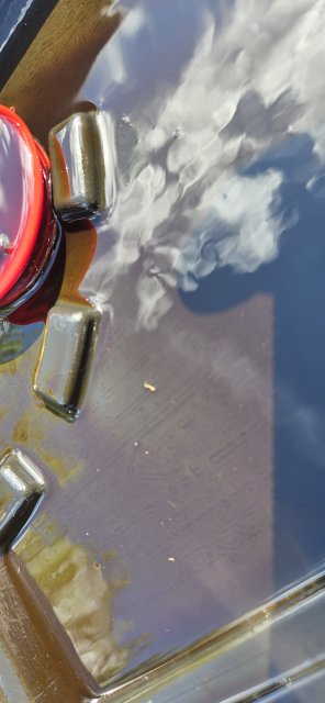

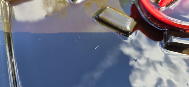

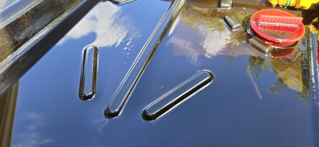

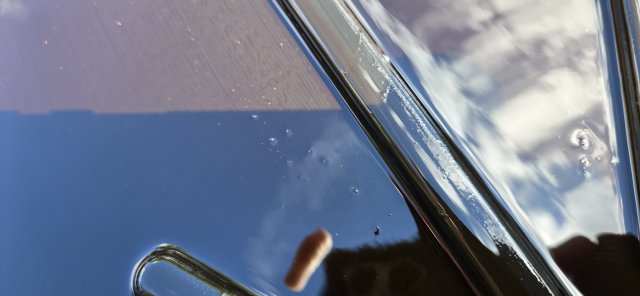

2022 Ford Explorer ST with 50k Miles. I change the oil every 6,000 miles with 5w-30 Mobil One Full Synthetic (About 6.3 Qt). Doesn't burn oil. Check the dipsticks every 2 weeks.
Found some oil in the filter and drain pan (See pictures below)
Engine sound normal for a Ecoboost. Still making power.

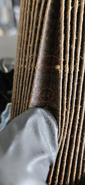

Going to check the oil filter Monday after work check for any metal.
23 Explorer ST
175
96
That doesn’t look good.
I would take it to the dealership since you are still under the power train warranty along with the old filter and pictures.
Curious to what they say.
Also take an oil sample to them with the metal shavings.

Talked to the Dealer Service, said there not much they can do right now. I guess just wait still she blow up.
Check the filter at 80 miles. No metal in the filter.
