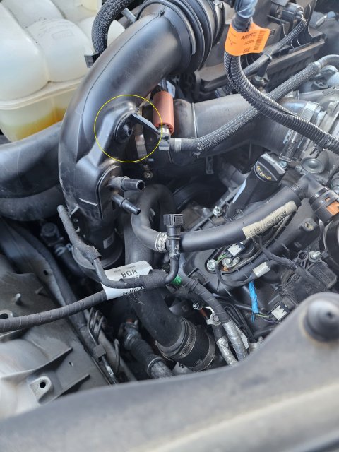

I broke this nipple off. And even better I dropped it below when I removed it from the clip. Anyone have any experience fixing a nipple like this? Or what the FoMoCo part number is for this charge pipe? Thanks.

Well I feel I am talking to a wall but all is good now.
Scoped cylinders, all good.
Fixed wastegate vacuum nipple (bored the hole to 1/2" and screwed in a male 6AN to 5/16" SAE nipple, it was a very snug fit and didn't seem to leak but I did put JB weld high psi type around it in addition just to be safe).
Drained tank (sketchiest stuff I've ever done, lots of Home Depot specials making a tee off the low pressure side with a valve that I could open a little while the car was on to dump fuel. Took about 10 minutes to drop ~15 gallons).
Added new E85, runs like a champ.
Lesson... Don't get E85 far away from home, road trips I'll be switching to 93 from now on.
