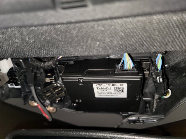

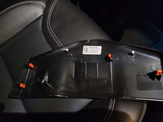

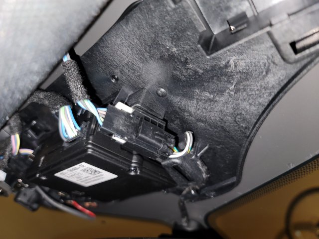

How exactly do you remove the cover behind the mirror to tap the power cables? Just yank it off? Making sure I don't break anything lol.
81
47
Lakewood, CO, USA
Yes, I just did this today, it just pulls off, I'll post pictures along with which wires to tap.
81
47
Lakewood, CO, USA

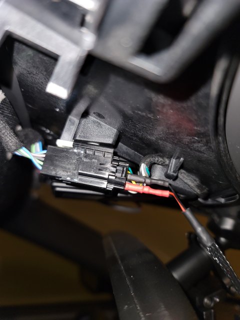

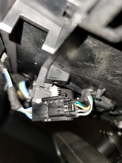

It's the harness on the passenger side, wire 1 (white) is positive and wire 3 (black) is ground.
81
47
Lakewood, CO, USA
It was much easier to pull out the mounting clip to see the connector straight on.
81
47
Lakewood, CO, USA

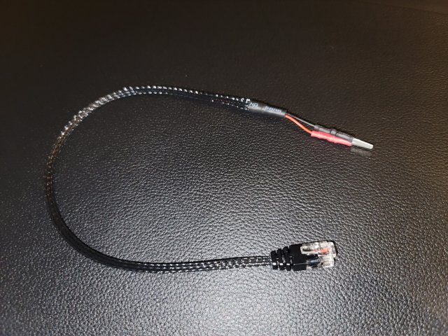

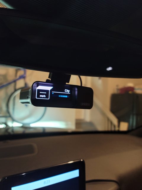

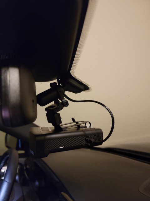

It came with zip ties to attach it to the existing mirror cable. I used a blendmount bracket attached to the mirror.
Zermus
79
34
Wylie, TX
Thread Starter #11
Did you use the 15" mirrortap? My blendmount came with the 10" and it's a bit short and I have to have it come out the side of the cover lol.
81
47
Lakewood, CO, USA
I think it was 12"
