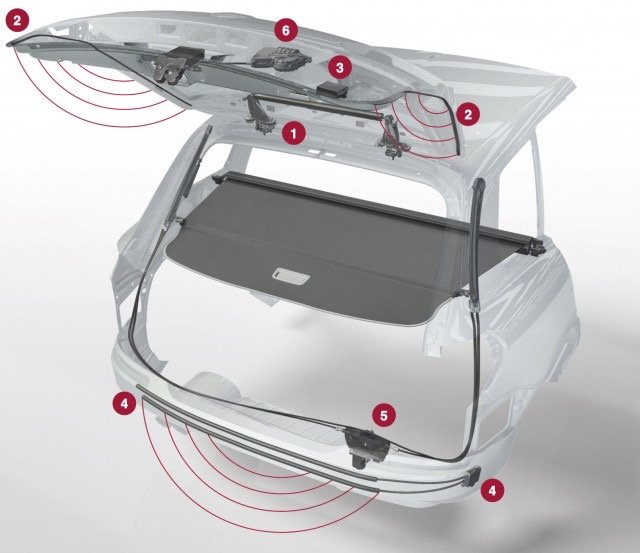

Ok so this is what I found a while ago:
And also this diagram, but it’s for a Ford Kuga which I think is the European equivalent of an Escape. In theory the principle should be the same, and the Youtube video link is slightly more helpful although it’s a generation old. On cursory inspection I haven’t found the same module on the new generation yet but I have not looked extensively either. In that diagram, I believe point # 3 would be the main target. Its exact location on OUR model, though, is not yet known to me.
Thank you so much for the effort and time you've put in to help. I will attack this in the next day or two and report back.
