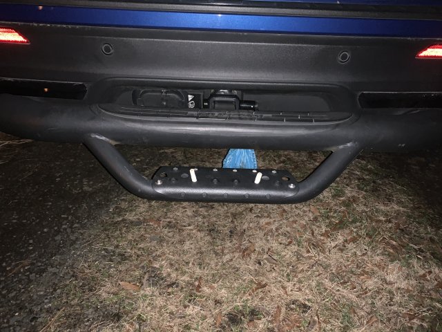

My tailgate is definitely possessed by an evil spirit. My garage is extremely tight and I manage to make enough room to allow the tailgate to be opened fully with the SUV parked and garage door closed. At least once or twice a day just walking by the SUV triggers the motion swipe feature that opens the tailgate. It is getting annoying. Does anyone know how to disable the feature completely? I found the switch disable in the touch panel options but none is available to disable the motion swipe. Any experts please chime in.
I I don’t know how to disable it traditionally, but......I have a Go Rhino bumper step in my trailer hitch. It sits out on the furthest bar… On my 20 ST, because of that step, the motions swipe feature does not activate. It also did not activate 36C446AD-FFFB-45B2-9669-CCD3F1DC3328.jpeg on my 2018 Platinum when I had the GoRhino hitch step installed on that vehicle as well.
