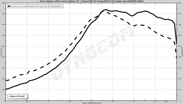

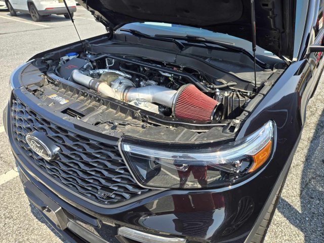

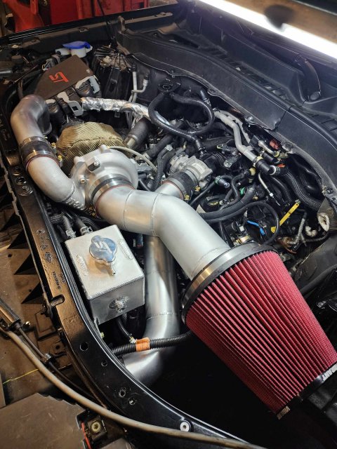

Just wanted to share with everybody who hasn't seen it already, we just set the new whp record for the Explorer ST at a whopping 839 whp!!!
This build has been a year in the making, and is the culmination of a lot of research and hard work by a lot of folks. The new bar has been set and I can't wait to see what comes next!

Build details -
Tuned by ZFG
Custom single turbo swap G35-1050 by MA Motorsports
Stage 3 built 10R60 by Kozmic Transmissions
All other install work done by Performance Evolution in DE
Upgraded hpfp and injectors
Suncoast torque converter
Graveyard coilovers
Steeda front and rear swaybars and endlinks
Steeda rear adjustable toe links
IDspeed rear diff brace
JXB driveshaft brace and diff bushing inserts
CVFab intercooler
Billet front control arms
BC Forged 22x10.5 et 30 wheels
315/35r22 SportContact7 tires
Custom high end sound system with all Focal and Helix components done by SoundFX in DE
