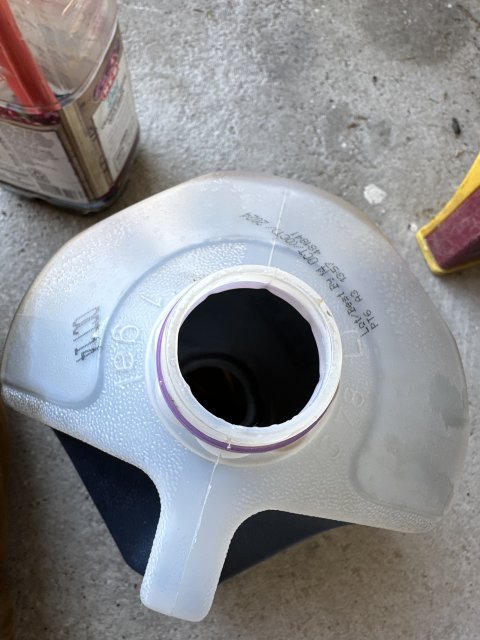

IMG_2333.jpeg Pulled the fluid out the pan and changed the filter. Def black but new fluid and filter in. Giving it a go. Did notice the downshift was the 7-6 downshift and there’s a vibration in the 40mph range. Is that symptoms of the FADA intermediate shaft business? It hasn’t been replaced on ours. We’re getting no lights or engine codes. Would be out of pocket to fix if that’s what it turns out to be

FADA is the Front Axle Disconnect Actuator. When mine failed it locked the vehicle in 4wd. I was getting a bunch of alerts showing up and couldn’t switch driver modes. I think your vibration is coming from somewhere else. Could be the exhaust, driveshaft, a differential, etc.

That was my initial thought means how we don’t have any codes or other issues. Just the rough downshift. Did read there’s a TSB for a snap ring in the transmission that causes some issues. Hell maybe trans is burnt up who know. Shifts up great, doesn’t search clunk. Just the one downshift spot from 7-6. Gonna do some digging on that and see what I can come up with. Thank you
