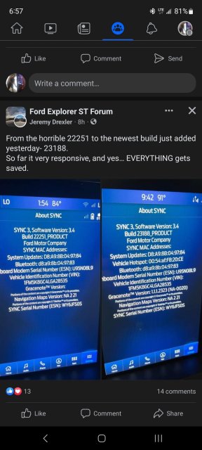

Too scared of bricking my APIM to try it right now........I will let some others be the Pioneers.

Cyanlabs find these new versions on Ford servers weeks to months before official release. In many cases though, there is a bug in them and they never get officially released, as seems to be the case with 23088. For most, waiting is the best option. Especially if on 22251 with full rwdata memory, you may not be able to do a standard USB or download update anyways. Maybe Ford dealers can update the Sync with FDRS that does not care if rwdata is full.
In any case, I updated 22200 to 23188 just now, about 15 minutes doing the app package only. Will be keeping an eye on rwdata to make sure it doesn't fill up.

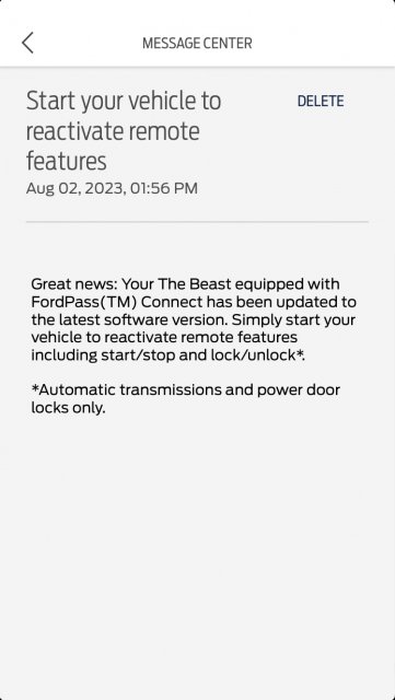

I just found this on FordPass. Is this telling me Sync 3 has been updated (it has not) or simply the vehicle’s FordPass software?

Ford Pass is saying a map update should be available on or about Aug 14th. Maybe A SYNC update is coming soon as in the past SYNC has been done a short time before a map update. We will see I guess.
