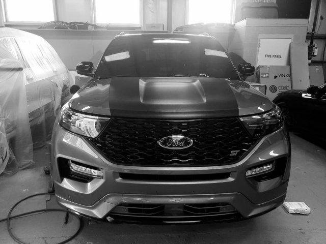

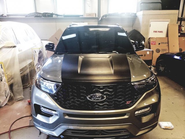

UPDATE FROM THE LAB....
Fronts Tinted 20%
Windshield Tinted 50%
Body Matching Paint is extremely labor intensive!
Off Body:
- Removed each piece and hand sanded.
- 2 coats of primer, hand sanded again.
- 3 coats of Silver Spruce, hand sanded between each coat.
- Fog Light Housing Gloss Black
On Body:
- 2 more coats of Silver Spruce blended with Fenders and Doors.
- 2 Coats of Ceramic Pro 9H Clear Coat
Going up on the lift to install Whipple IC, H&R's, Borla Exhaust, UPR Catch Can (w/ high performance PCV line, magnetic drain plug & drain line), Steeda Rear Sway Bar, Dynamic Diode LED's, Redline Hood Struts, Gorilla Lug Nuts.
**Tomorrow is Vinyl Wrap install day! (Roof, C-Pillar and Center Hood)**

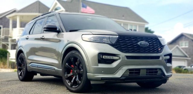

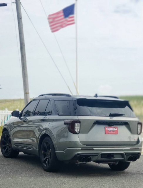

After a week of sanding, priming, (sanding), painting, (sanding again)....Quick sneak preview of the back with OG pictures for reference.
Darkened the Tail/Marker lights and Tints on windows/windshield
... Still have the front nose off for IC install and hasn't been dropped or Black Chrome Borla tips. Still needs the vinyl on the top as well... But I'm already loving it

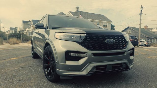

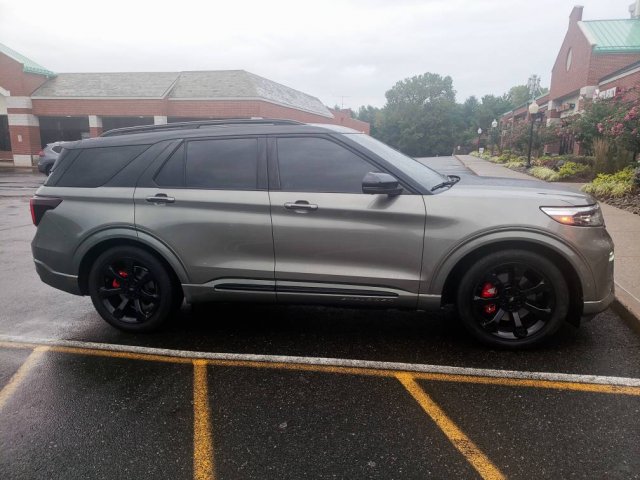

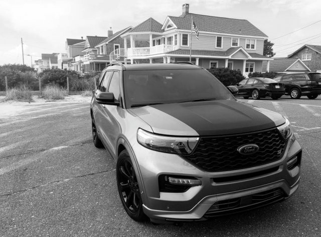

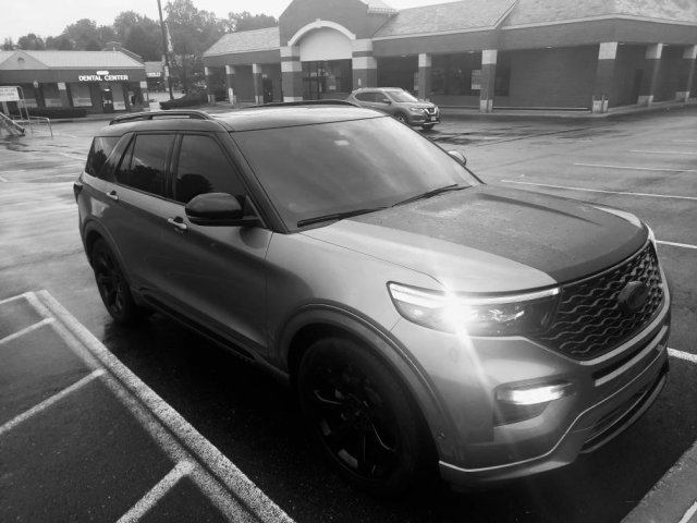

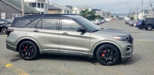

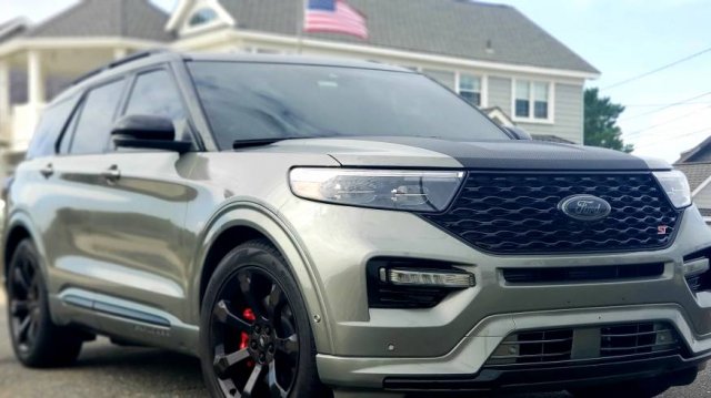

Good Morning Gorgeous!!
Some rainy, early morning, first light photos and videos of the finished product! I couldn't be happier with the outcome. Only thing left to do is delete the Roof Rails (after 9/1, backordered) for the Slick Top Interceptor look to make the stance even more agressive...
Next stop... time to get to work with Adam from ZFG Racing for a 93 Performance Tune to squeeze every drop of juice that she has!
Since there's no Ethanol Fuel to be found in NJ and after a lengthy, detailed conversation about the benefits of Methanol vs Ethanol with my mechanic... I am considering installing a Methanol Fuel tank to be calibrated to spray at 3,000 RPM'S (with a kill switch for economic driving circumstances and Methanol conservation). This is an inexpensive Mod (roughly $1,000) and with a 1:1 Methanol to Water ratio... can deliver an additional 40 WHP, while decreasing overall temperature and keeping the engine in good health and super clean. Gonna let her break in a bit first and see where the ZFG 93 Tune takes me first.
The lowered stance from the H&R's and the Steeda Rear Sway Bar make this thing corner unbelievably well. I can cut 90° turns at 40mph and she sticks it with no roll whatsoever! Quick Lane changes are immediately responsive and entering/exiting corners are fucking incredible!!
Borla S-Type Exhaust is perfectly throaty enough for me. ** Still have to install the SPD Catted Downpipes next week to complete the complete exhaust system. I don't want the obnoxiously loud sound from a 6 cylinder Turbo charged engine and I certainly don't expect to have the menacing growl similar to my Flowmasters on my V8 5.0L Mustang... Bottom Line for me the sound let's you know that this BadasST doesn't **** around!!
I've purchased this truck on 7/24... But I've been dreaming about building it since it dropped in 2019. After several weeks without the Truck while she was in the LAB... I get to take her on vacation to the Jersey shore down in Lavalette, NJ and enjoy my new BadasST build!
I ABSOLUTELY LOVE THIS TRUCK! View attachment 20200829_064358_02_1.mp4 View attachment 20200829_064656_02_1.mp4 View attachment 20200829_064605_02_1.mp4 20200829_093112.jpg 20200829_093215.jpg 20200829_064656_01.jpg 20200829_064452_03.jpg 20200829_064634_03.jpg 20200827_165359.jpg 20200827_162821_03.jpg preview.jpg

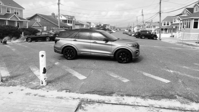

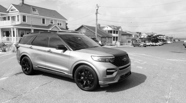

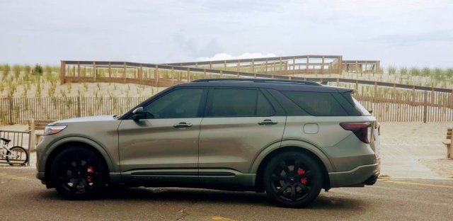

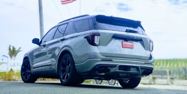

Model Shoot at the Beach... 20200902_102122.jpg 20200902_102308.jpg 20200902_102426.jpg 20200902_102346.jpg 20200902_111934.jpg 20200902_111447.jpg 20200902_111127.jpg 20200902_110402.jpg 20200902_101053_03.jpg 20200902_111318.jpg 20200902_102257.jpg
