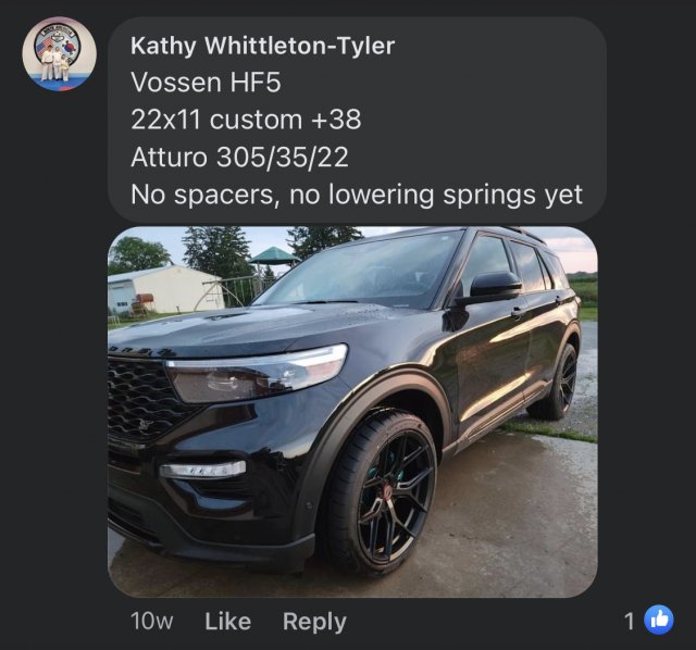

top pic is on steeda’s

That’s the same car in both pics and that’s a very very narrow running 305. I won’t clog up this build thread anymore but I’ll say be very careful and specific with an 11” wheel and 305 tire. Backspacing and tire width will make or break it.

All of the “Chinese” brands run super narrow. Arturo, Lionheart and Lexani for sure. Pirelli and Michelin run closer to true width if not even a little wider. Any tire with some sidewall bulge on a +38 11” wheel will likely be problematic when it come to the front struts. I’m sure you’ve seen this first hand.
I would bet the tires on those pics measure closer to a 285-295 in reality…a 12” wide tire shouldn’t be stretched on an 11” wheel. I’ve had Lexani and Pirelli 305/35’s on mine at different times…they aren’t even close to the same.

It's possible that the Atturo 305 tire is much narrower than most other 305s. My Lionheart 285s had a noticeably narrower contact patch and more rounded sidewall than the Michelin Pilot Sport 4s, despite both tires being 285/40-22s. EDIT: when I say "rounded" I mean stretched, not bulging. Most people prefer the squared look, I prefer the stretched look.
The Ferrada CM2s have a *VERY* concave face, much more than anything I've seen Vossen has available for this application (so it is an aggressive fitment). 285/40-22s will fit with no issues. 285/45-22s will fit on the back (don't ask how I know lol ). Even the narrowest 305 won't fit the CM2s as I've extensively checked clearance front and back and clearance is tight with 285s.

I just posted a pic of someone running a 22x11+38 running a 305/35/22 tire and you are telling me no one is running it. It’s easy to verify the tire specs to see the difference in tire specs
I have pics of their inner barrel and tire to verify. I would put money on it working with the Ferrada’s too if your offset is +38 which it very likely is. You can determine the offset yourself using the method I posted earlier in this thread.
regardless my point is 305’s are absolutely a possibility.

Some, not all. Put a Michelin Pilot Super Sport on it and report back. As I stated earlier…that Arturo “305” likely measures out to a 285/295 at most.

Lexani’s and lionharts are wider and taller than the Michelin’s in this size. I’m sure they would be fine. This isn’t as tight of a fit as you guys think there is a lot of space in these wheel wells. Regardless I don’t think there is anything wrong with 285/40/22 I would actually prefer that size with the 11” wheels.

No, they aren’t. They aren’t even close. The MPSS is the widest of the 305/35’s. Pirellis are a close second. Lexani and Lionhart aren’t even close. I’ve owned them all except the MPSS…on the same wheels…on this car.
