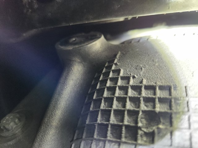

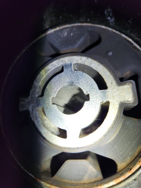

I just had my 2021 ST break the rear bolt yesterday with only 9050 miles on it. Wife was driving it accelerating from a stop sign pretty close from my house when the bolt snapped. She wasn't launching as she had the kids n she doesn't launch it to begin with. She limped it home n parked it. When I woke up for work she told me (work nights). What she described n the kids said sounded like the rear axle bolt. Shined my flashlight under n saw it hanging with the bolt gone.

Can you see any leftover bolt in the diff cover hole? IIRC the bolt cannot loosen and fall out due to interference.

Looks like thread remnants in the hole to me. The broken off piece obviously fell out along the road.
Zooming in on the picture, the bolt broke just below flush with the cover.
1,502
I doubt it. If that were true, you wouldn't be able to tighten or loosen the bolt. And...it's obviously gone.

Yes the head of the bolt is gone and the remaining piece of the bolt is still inside the threads

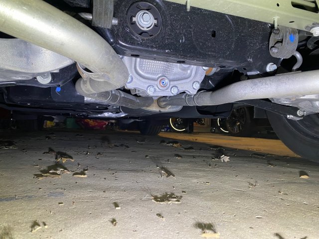

Just had my car serviced under the recall (22N06 Rear Axle Bolt Replacement). ST was returned with one bolt, anyone else have this issue rear diif.jpg ?

Just had my car serviced under the recall (22N06 Rear Axle Bolt Replacement). ST was returned with one bolt, anyone else have this issue View attachment 15667 ?
No one has because the recall isn’t meant to do that. It’s strictly a software “fix”. Read the recall notice and you’ll see. It’s been talked about numerous times here.
5,015
6,004
You always only had 1 bolt there. They didn’t change anything.
