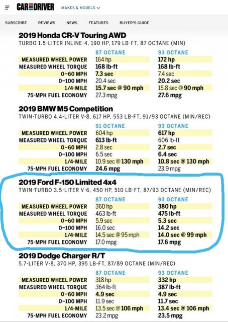

A higher ethanol content will always result in lower mpg- just due to the BTU content as I posted earlier. As far as "In the US the difference in price between 87, 91, 93 is negligible"- at my fill-up last week in my area of TN, 87 is 70 cents cheaper than 93! Were I to buy no-ethanol 93 it's 90 cents.
Even then, 87 with Ethanol is better than 93 without ethanol. At least for our SUV's according to Adam.

If you're just talking about mileage and not horsepower, all ECU settings optimum, mathematically on a part throttle cruise (highway) there isn't any reason to see less MPG on 87 than 93 unless the blend somehow has a higher BTU content.
So, if you're only interested in price per mile, 87 octane as long as it's cheaper is always going to give you a better mile per dollar than 93. If you're willing to give up horsepower (which is driven by peak torque or avg cylinder pressure), 87 will always win. The key to understanding this is because we're measuring part-throttle operation which would yield the same BSFC numbers at equivalent RPMS which is independent of octane rating- unless as stated earlier the 93 blend has higher BTU content.

As far as your first statement, you're a little off. A Prius (for example) will require around 20 HP to overcome the various parasitic losses of the drivetrain and wind resistance at 65 mph. A box-like ST with AWD and much higher parasitic losses will require a much higher amount of energy to do the same. That's why that Prius will get ~45 MPG highway to the ~25 MPG on the ST.
If you're talking about not giving up HP for gas mileage, that's completely up to you. However, I think you're way off on the concept of torque. Torque is a static measurement and is a product of average cylinder pressure- period. Cylinder pressure is a measure of VE and air density. 93 will produce more torque than 87 because of detonation resistance allowing higher air density, but this has nothing to do with gas mileage which is a function of the parasitic losses and the BSFC (brake specific fuel consumption) of the engine at some particular RPM and load.

Really? I'd truly like to see some documented evidence of 9HP at 60 mph! As far as "it stands to reason if the engine can produce enough horsepower at 10% vs. 13% it'll use less gas". Not necessarily true. Do a google of BSFC maps and look at one. BSFC numbers when mapped against RPM and load are islands similar to compressor efficiency maps. Lower RPMs do not mean best BSFC numbers.
Best BSFC is generally at peak torque. However, we don't normally drive around at 60 or 75 at peak torque which means we're using some sort of throttling mechanism. Whether that's done by closing the throttle body, inducing an Atkinson-style mechanism through use of variable camshaft timing, or inducing EGR the BSFC maps are all over the place. The manufacturer purposely uses certain gear ratios to get the best BSFC numbers You're also not considering auxiliaries- pumps (oil, water), valve train (higher power required at lower RPMs) losses.
So, I'm not sure why you decided an article you read "decades ago" before any of these innovations is relevant. Let's take a Tesla. Very aerodynamic and more so than the Prius, wouldn't you agree? Their 75Kwh battery pack is rated at 255 miles (they don't list speed) so we'll just pick 4 hours equating to 63.75 mph (close to 65). At that pace, it's consuming 18.75 Kw. That equates to over 25 hp. The ST is nowhere near that aerodynamic and has an entire thing called an automatic transmission (which the Tesla does not) sucking up valuable resources. See where I'm going?
