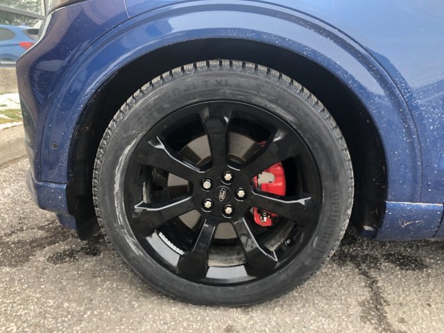

Winter has arrived in Toronto. Just mounted up some continental ice contacts. I am still a bit shocked at the price tag 1900.00 cnd out the door. They are supposed to be great I will keep you guys posted

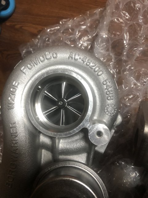

Just received the modified turbos back from cr performance hoping to get the truck into the shop (Ford dealer lol) for the downpipe/turbo install sometime this week. Adam (zfg racing) has a 93/94 and a e40/e50 tune we are going to try out. Hoping the xdi evo pump and the stock injectors can give this thing enough fuel.

mruff1975
122
94
Toronto, ON, Canada
Thread Starter #54
I bought turbos from my buddy at the dealer and sent them up to him. I got a fairly good deal on the turbos (cost and paid cash) cr is only a few hours away from me shipping was fairly cheap
