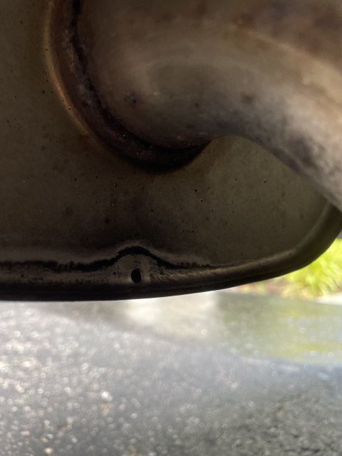

Can you post a picture of where you drilled the holes? It might help other members if you would, thanks.
Covered in post #7.
It’s not rocket science…small hole in the lowest point is all you need.

I assume it's possible to do this with the mufflers still on the vehicle?
And I'll ask again - any noticeable change in volume due to getting the water out?
Preferable to do it on vehicle so you can hit the low spot. I never ram it without the holes so I can’t say if it is louder but doubt you could tell the difference.

Just drilled a hole in each of mine. 5/32. I was shocked at how much water came out. I’d venture at least 12 ounces out of each if not more.

Any special tips or tricks for drilling? Or do you just take the bit to the muffler and drill away?

Nothing to it. Laid on my back and just took a bit to the lowest part. Poked thru and water came out right away.
Yep. It’s very surprising when you realize how much water has been chilling in there.
