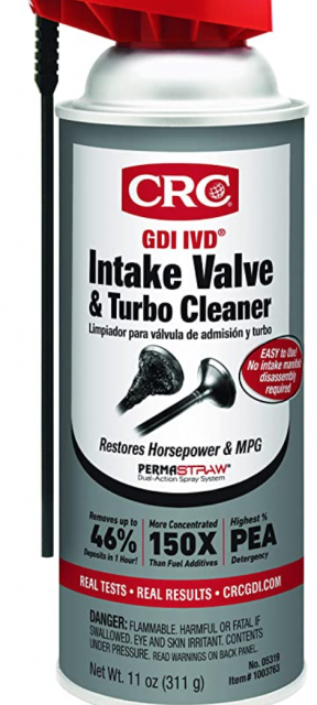

I plan on using the CRC Intake valve/turbo cleaner every oil change as i've seen what intake valves on a DI N/A and supercharged silverado look like
I think this was covered in the past that cleaners could knock deposits loose that could damage the internals of the turbos. That is why people are using the catch cans to reduce the deposit potential versus using the cleaners.
