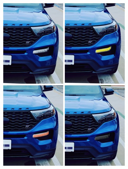

Deciding on a front fog lamp tint.
Smoked >= Yellow > Amber > White for me.
No such confusion for the rear.
Smoked any day over chrome.
I might need an LED update after tint, for the reverse lights.

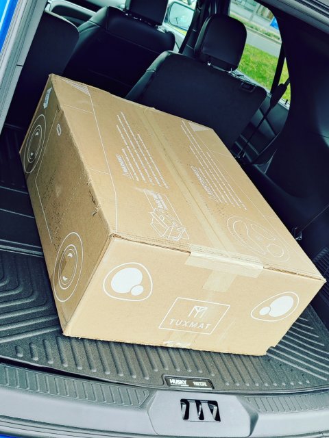

Tux on a Husky.:p
It's finally here after traveling 2500 miles.
They have made the box interesting this time.

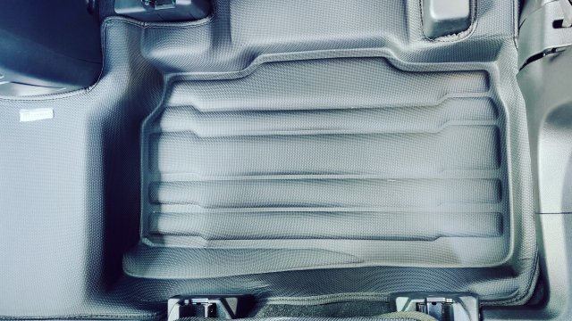

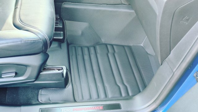

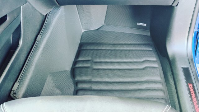

Tux-Mats Front Row - I'll let the pictures talk for themselves.

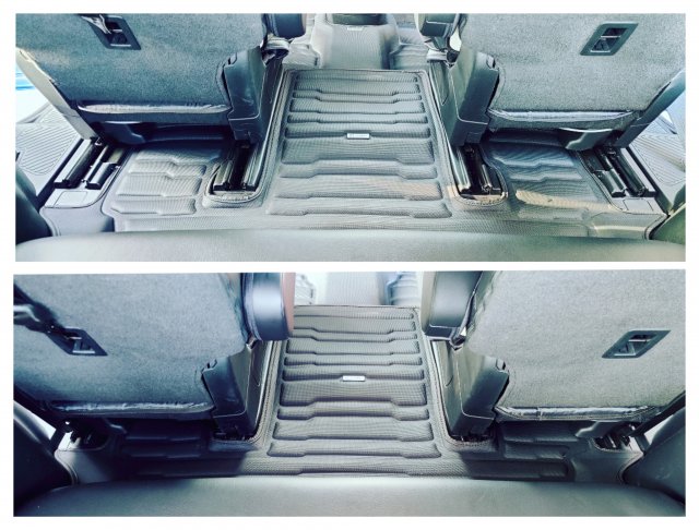

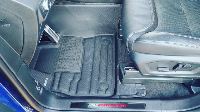

Tux-Mats - Second & Third Rows
Third Row, with second row seats in extreme positions.

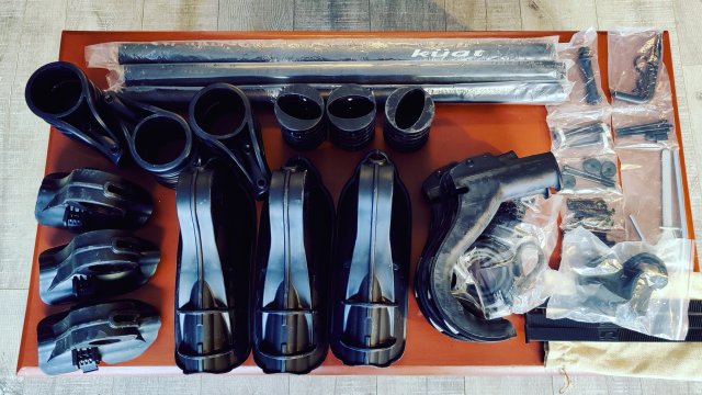

Kuat Transfer V2 bike rack is here.
The package was in really bad shape.
(Amazon order with UPS shipping. FedEx did a great job few days back, with my TuxMat direct order)
All the parts seems to be there.
I might return if anything is wrong, after assembly.

Those are nice. How are you liking them after having them in for a week?
In short, they are great. Truth be told, I have installed them and then forgot about it, in the ST. But I have used them over two years in my last vehicle.
+ Almost 100% factory carpet is covered, in all three rows. (this is very important to me, as my younger children will put things into, hard to reach and hard to clean, places)
+ They are very very durable
+ I like the color and pattern, that goes with the rest of the black interior
+ No matter how dirty they are, very easy to get them back to new look, after a 10 mins cleaning.
+ Dust, dirt, mud, snow, beach sand, goldfish, No problem.
+ This smoothens factory floor imperfections. For ST, there are some uneven hard surfaces in passenger foot area, they are less noticeable now.
- material is kind of 10% rubberized feeling and 90% plastic feeling, to step on. So you will lose the soft, cloth carpet feeling on your feet.
- Not easy to take it out very often, as I have used the clips and Velcro strips that came with it, to fit them perfectly.
- because of the groves in the design, vacuuming and wiping it down will need multiple passes.
The last two negatives are not applicable, if you are not an OCD guy like me. If you just put them in 5 mins (and not fix them perfectly, with all the clips like me) you can also take them out in 5 mins, and hose it clean. Just make sure to dry them fully before putting it back, as moisture can get trapped under it forever, as the material is not breathable.

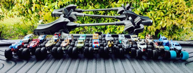

Now there is space for all our toys..

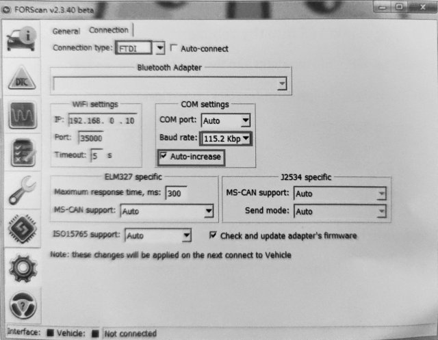

Gearing up for the FORScan changes.
Went with VGate vLinker for its lower price compared to the OBDLink adaptor.
It was cheaper on direct website, but went with Amazon for the easy return option (if anything goes wrong with the order).
Since the information I could find for FORscan changes are scatted all over the web, I have decided to make my own checklist for the changes.
I will document them in this build thread, for keeping a log for myself. Also might help someone specifically looking for Explorer ST changes.

With all the right setup (above post), the connection with the vehicle and the adaptor performance was really good.
First time loading the modules took few seconds, but a lot of them were there.
You get to select a profile name for when you connect the first time and it will ask for which profile to load every time you connect to the vehicle.
Below is the extract from FORScan

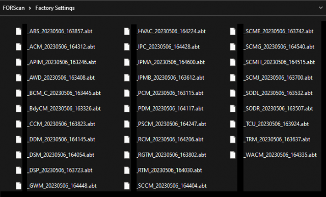

As Built Module Backup: Most important thing to do, before you start playing with any module.
Its very easy to mess up the settings and then the factory As Built backups becomes a lifesaver.
Backup process
Restore process
After backup, windows had the following .abt files stored.
Took around 20 mins to finish all the As-Built modules available.
