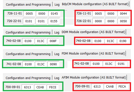

FORScan Change: Remote Global Close
Module : BdyCM - Body Control Module
Method: Easy click select multiple options (not As-Built)
Status: Did not work
Plan: Need to try As-Built method, with multiple module changes, to figure out this one.
Plan Worked : 05/07/2023
Method: As-Built Modules BdyCM, DDM, PDM, AIPM
Status: Working successfully :cool:
Working : Now both front windows can be opened and closed from the remote.
Changes made (in green boxes) as below: Red boxes has the old values
