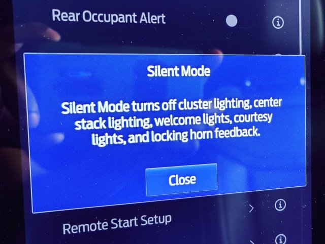

Ok, came back out after lunch and it was avail. Did you actually try it to see if it works?
Full system shutdown by
1. Switching off by pressing start/stop button.
2. Open driver door. (Center screen switches off)
3. Close driver door.
4. Switch On by pressing start/stop again.
Yes it works perfectly, after multiple drives. Everything is turned off when I toggle the silent mode. And everything comes back when I toggle it back.

Just went out to test it in dark. Figure easier to see. Toggled on, then off. See no difference.
Did I miss something?
R2D2
293
222
LA, California
Thread Starter #64
If the silent mode is toggled 'On' from the center screen, on exiting/ locking the car, none of the external lights will be on. That's how it is still working on my ST.
If it's not, then try loading the factory settings once more and enable the feature one more time.
Thanks for your help. I will check again. I was under the impression interior panel lights and such would go dark as well. So no puddle lights either, headlight delay etc?
Sorry for being a pest.
Yes. Use case for people going for hunting, star gazing, watching drive-in movies, etc. Where you doing want all the vehicle lights lighting up the surroundings.

FORScan Change: Silent Mode Control Function (Dark Car mode)
Module : APIM Module
Method: Easy click select
Status: Done Successfully. Toggle button gets enabled in the Sync 3.4 and above
Thanks @Max Salvo for asking about it. Its so easy to do in Sync 3.4 and above.
I will keep this option off almost all the time, though. Who doesn't like the Christmas light show. :cool:
This worked perfectly for me. Pressing the lock button on the remote during silent mode does not flash the lights or sound the horn. This is exactly what I was looking for. Its surprising the toggle switch/option isn't enabled from the factory.
Thanks again for the detailed instructions.

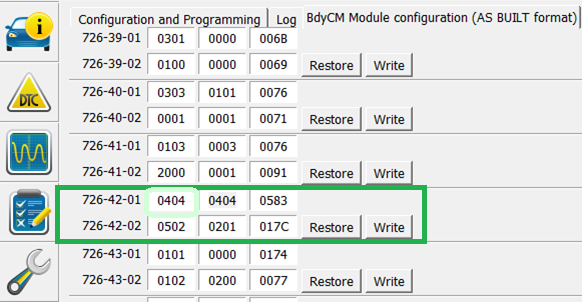

FORScan Change: Amber DRL with/without White DRL
Module : BdyCM - Body Control Module
Additional Change : If you don't want the White DRL
Module : As-Built Modules BdyCM
Change : 726-42-01 x4x4 xxxx xxXX (original value was 0303 and new 0404)
Status : Working as programmed.
Note : Feature works when the vehicle is running, during day time (when DRL is supposed to work) and when Headlights are in Auto.
Pictures of Amber DRL working with and without White one
Very useful and interesting. Thanks
