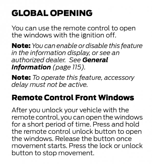

Hi, I did what suggested, but only the front windows closes and none open up. I have checked twice the settings and they are ok. In the screen the opne close functios are visible and enabled.Thanks
For the current US model ST, global open is enabled by default from factory. See the extract from the owners manual.
The changes I did, enables the global close only. Even though the function says global, it refers to the front two windows only. There might be a another way to make it work along with the rear and sunroof.

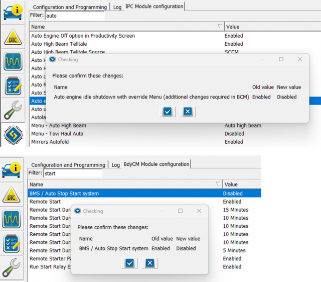

Thread Starter #83

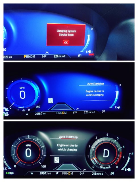

FORScan Change: Auto Start Stop Disable (Battery Management System method)
Module : IPC and BdyCM Module
Method: Easy click select
Status: Auto Start Stop is Disabled in all drive mods.
Issues : I am not clear on how its going to affect the Battery charging part of the vehicle operations. Also a warning is shown on every vehicle startup. Will keep it for few days and revert back.

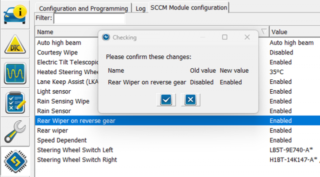

Thread Starter #87

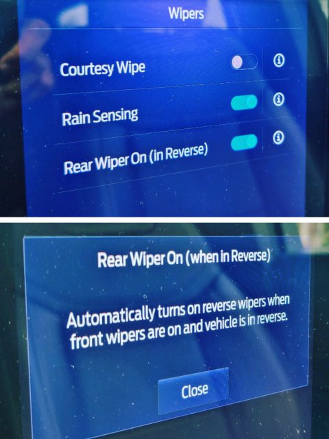

FORScan Change: Auto Rear Wiper on Reverse
Module : SCCM Module
Method: Click select
Status: Done Successfully.

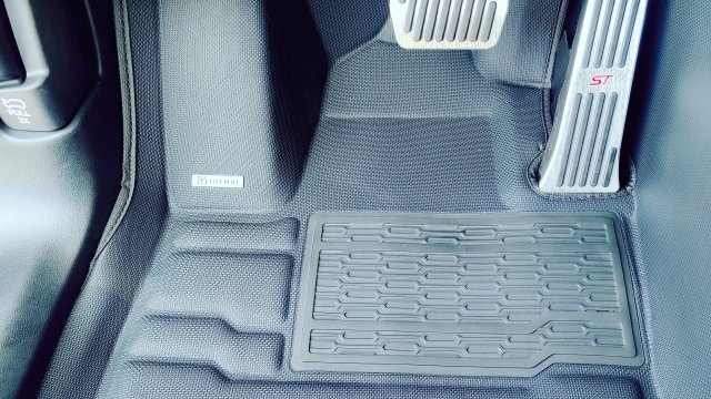

+ No matter how dirty they are, very easy to get them back to new look, after a 10 mins cleaning.
Make it an hour (first vacuum, then with wet cloth, last with dry cloth) for detailed cleaning all three rows and cargo area.
Cleaned the mats for the first time after 40 days. It was very dirty with all the accumulated dirt from Antelope Valley to San Diego beaches.
It's back to brand new look. Now I don't feel like stepping on them. :LOL:

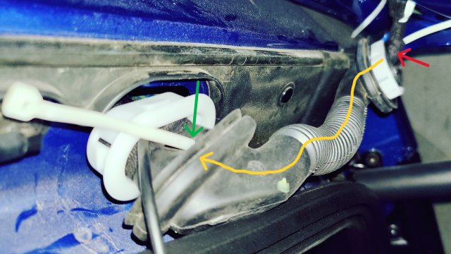

Thread Starter #94

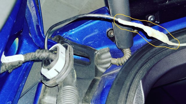

Rerouting the Rear Dash Camera cable through liftgate cable management tube was a long pending task for me.
Finally I gathered the courage and did it yesterday.

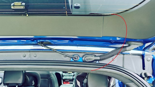

Below picture is post installation. the red line is where the cable used to be dangling, when the liftgate was opened.
The weather proofing seals/clamps of the rubber tube, that carries all the cables to the liftgate, is in a tricky spot to begin with.
They gave quite a fight before they came out. This was the primary reason why I kept procrastinating this one task.
I used one plastic trim pry tool and one regular flat head screwdriver to press on the white clamp under the rubber seating to pull it out.
At the liftgate side the opening was good and had enough space for more cables. But on the vehicle body side, there was no opening.
I even removed the white clamp from the rubber part and found out it was well insulated, much deeper, to prevent water leak into the cabin.
I cut opened a small hole inside and pushed in a long enough and stable enough Ziptie through it.
Entering from the red arrow side and exiting at the Green one. It was easier than what I though it would be, considering the exit was very small opening.
Also you can see the black cable coming out of the white clamp, from the behind the headliner / D pillar area.

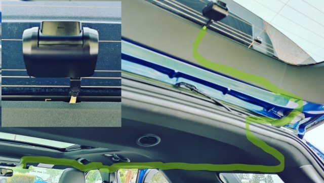

I attached the cable head to the ziptie head and used some regular white tape, without making it too bulky.
I did not use any lubricant (because I did not had anything handy that time), but the cable came out without any difficulty. (Sigh of relief)

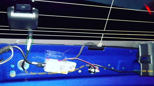

Used the same ziptie, to fish-out the cable two more times, through the liftgate access holes, before reaching the rear camera.
I have removed the liftgate top trim panel (just slide in your fingers and pull down to open) and few wiring there looks delicate. Practice caution around those.
I added a small layer of white tape near the end of the cable to prevent pinching from the trim panel.
I have also made a small opening on the trim piece, again to prevent any pinching that might happen while fitting it back.
The yellow marker shows the completely hidden cable route from the main front unit to the rear one.
Total two hours for something that was barely visible when the liftgate was closed. Totally worth it.
Spot the differences between the before and after pictures :LOL:

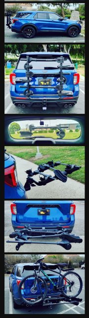

So far, everything looks good.
18, 20 and 29 inch bikes fits nicely.
Feels solid, but it's too early to comment on anything else.
I might convert this back to a two bike rack, for handling convenience. (Rack is heavy at 51lb and difficult to reach the tilting pedal, in the three bike configuration.)
Don't invest in the transfer locking cable accessory from Kuat. I bought it, as I needed a hitch lock and I got it used at 20$. Not worth at the original listed price, as it was designed for an older model.
And yes, the rear brake assist works on my ST. And constant beeping will remind you to turn off the parking sensors everytime you put into R.
I get a lot of questions about this one from general public. After two months of usage, my thoughts remain the same as the original post. It was a really good buy.
I leave it on the vehicle almost all the time and I have to be cautious and work around a few things
  1. Switch off the parking aid at startup or when I move to shifter to reverse
  2. Not accidently open the liftgate from inside
  3. Account of the extra length, especially when loaded with bikes or when I have to open the liftgate
  4. Partial/blocked rear view from the camera and mirror
  5. Chimes and warnings about reverse brake assist being unavailable.
  6. Pressing the adjustment pedal/handle is a pain with the three racks in place.
Still deciding on which one of three racks I have to remove for reducing the weight and for getting more rear view from the setup.

Module : APIM Module
Status: Done Successfully. Toggle button gets enabled in the Sync 3.4 and above
Thanks @Max Salvo for asking about it. Its so easy to do in Sync 3.4 and above.

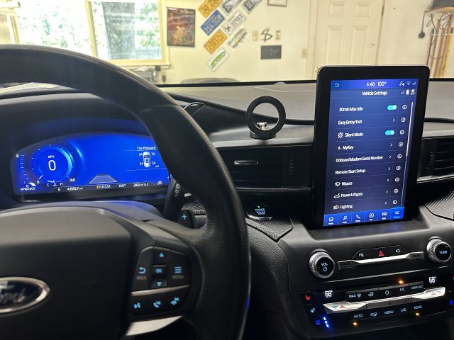

I will keep this option off almost all the time, though. Who doesn't like the Christmas light show. :cool:
Tried this and I get the silent mode toggle, but nothing changes when I turn it on. I have my headlights turned off, but the dash, radio, window switches all stay lit…the overhead lights come on when I open the door..
is there something I’m missing or messing up?
