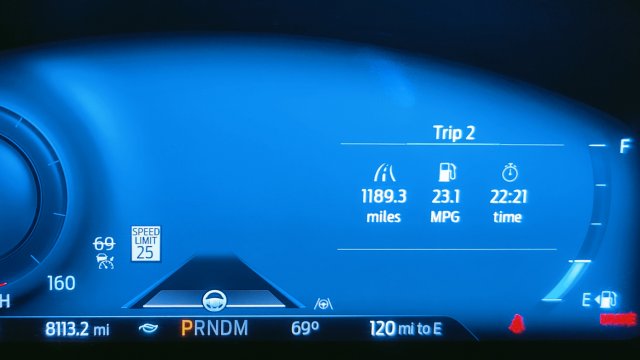

Finally added few miles to the odometer.
Grand canyon run and some bit of Route 66.
1190 miles roundtrip @ 23 mpg.
With 100% Eco mode and on regular gas.
With intelligent CC set at 10 over speed limit.
Climate control set at 72 with ventilated seats.
4 people with 3 days luggage.
Looks like completely opposite of what most of the people will be doing in an ST. I wanted to see if I can get anywhere near to the advertised milage. My usual average in LA is 15mpg.
ST did great for this family trip and we all came home with zero fatigue. Feels like I hardly did any driving. Other than, shaking the steering wheel in-between, just to let ST know, I'm still there in the driving seat.

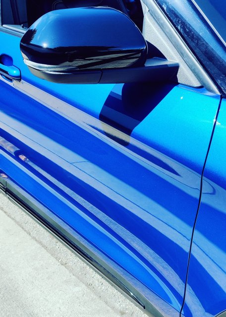

ST got a decent wash after so many months.
Atlas Blue shines differently under shade. It hides dirt and dust, much better than my last black car. Happy that I got blue, even though I was not very sure when I bought it.
