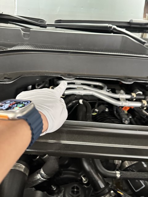

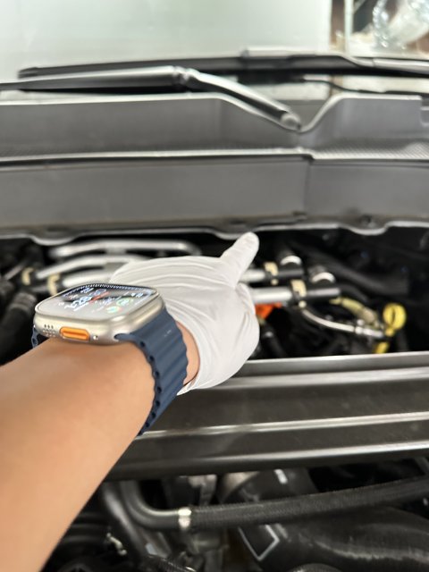

Triangle piece is the overlapping heat shield that contacts the body if vibrating at high speeds.I am pointing to the clip that was basically off and the bolt near the rear wheel threaded on by two turns. I am also pointing to a location behind mid pipe where bolts were also could be tightened, the pictures are not all inclusive. I suggest you hunt around with a wrench and start tightening everything.

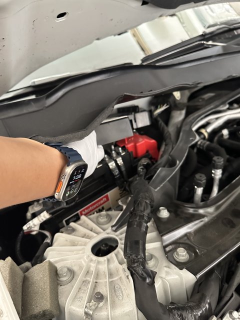

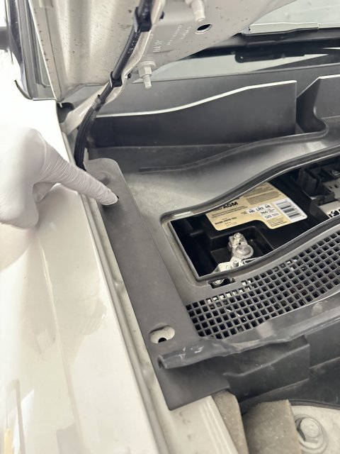

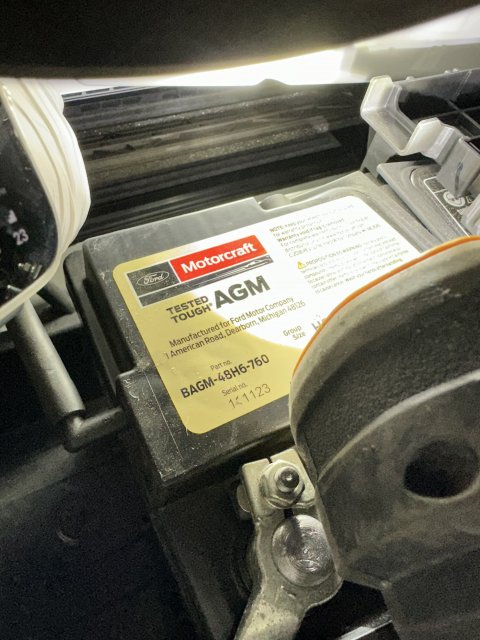

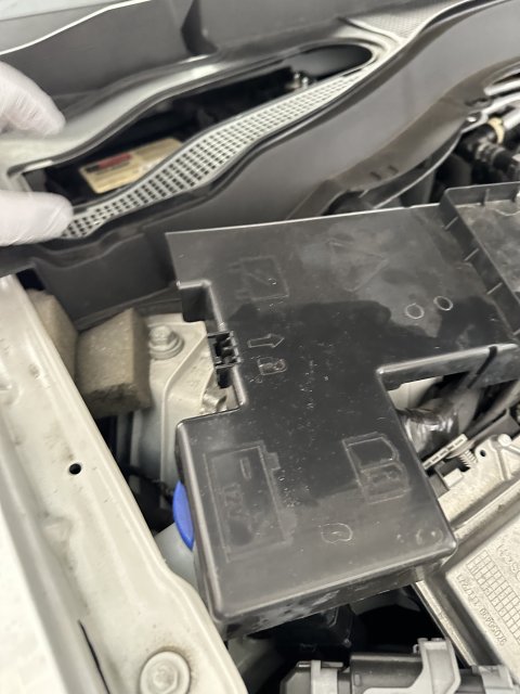

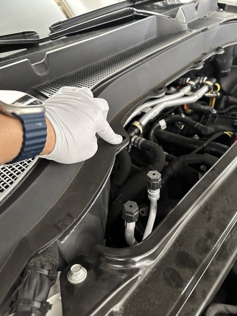

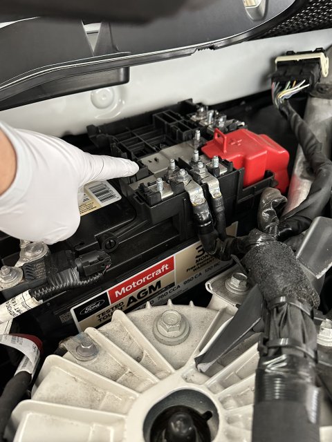

I think I found the culprit, brain storming on how to fix.
its the flap that recirculates air in the cabin filter that thunks/makes noise. When closed it is silent. When opened it rattles, will test my theory out. It is right where the battery bay is.
Took some pictures on how to get there.
The battery cover is also wobbly and lose could be that.
Will tape around and secure each one to see if it makes a difference.

What part is that again? Under the cowl?
Sounds about right. But what confuses me is the inconsistency.
Went back and reread your text. Does it happen when the recirculator is on or off?

The noise should only occur when the recirculator is off. I need to test it out to validate the idea.
The part is the recirculator flap (and you should see the cabin filter there). You access by removing battery cover plastic, then the cowl screws and clips, then the battery clip on cover, the lift and you should see it behind battery. If there’s a way to disable the actuator it could solve it. I also never want my recirculator disabled/open because SF has sooo many cars and exhaust smell, asian and german cars dont auto disable but some reason the ford does.

Tried getting some stuff done between the rain drops.
- Turned circulator on. Noise still there.
- Turned it off.... noise still there.
- Turned all systems AC/Heat off, etc. Noise still there.
- I actually was able to get my arm/hand behind battery... flap is solid, no movement.
- The whole cowl in front of windshield left to right is solid. No movement.
- Took everything out of glove box and lowered it. Nothing loose. Fuses solid. Filter cover solid, etc. Was going to remove filter cover, but didn't think there was a point being I was able to test it from behind battery.
I really want to get this resolve and hopefully Dale figures out something. I'm rooting for him or anyone that resolves this issue.
OR, I'm back to square one with the right strut being bad.
