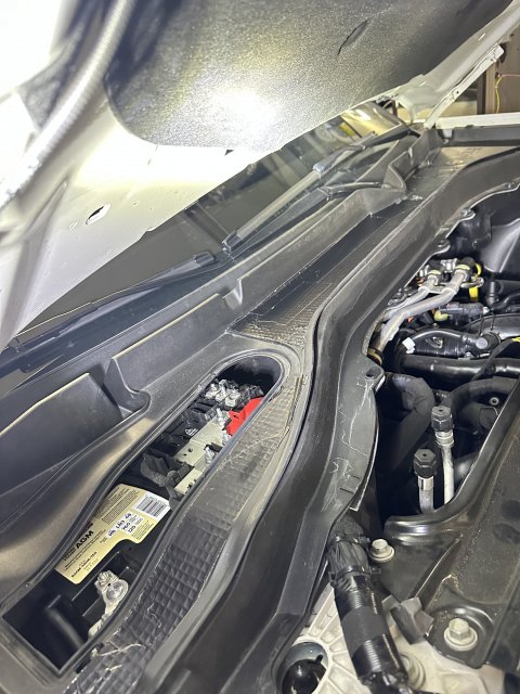

I wiggled anything can/could move and locked it down with felt, foam, zip ties. Noise is isolated now and random at low speed even with recirculator on. I also completely "metal hvac duct" taped the exterior air going into the cabin which is a plus for me since I never want the recirculator off anyways due to all the smog in the city, so at least I solved something.
No time to take it to service until I am back from vacation in Jan, but it's clear now that service won't pin it on anything else.

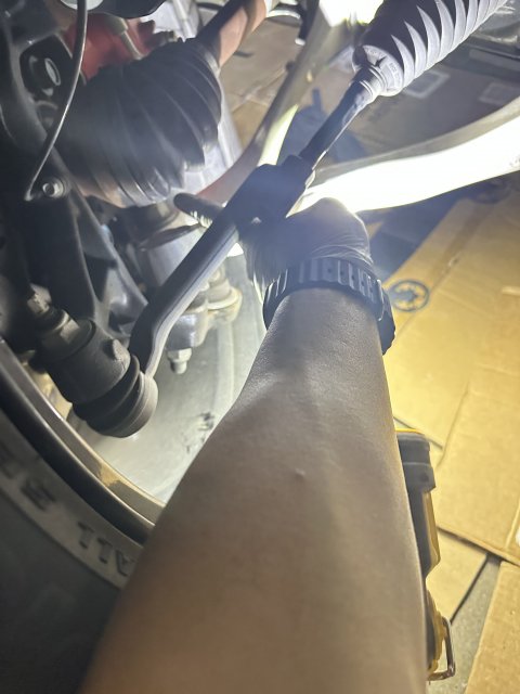

I did also monkey around the suspension in the front passenger wheel. I found the lower sway bar connector a 1/4 turn lose with a 1/2 inch wrench. You shouldn't not be able to torque anything down in that area by hand, so I monkeyed it down even more after the find. I am pointing to it in the photo.
The stuff that moves:

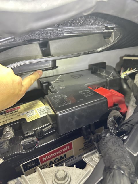

1. The battery cover can make contact with the positive terminal tray in the back and front, added felt here.
2. There's a electrical connector that can wiggle in the center cowl, zip tied that.

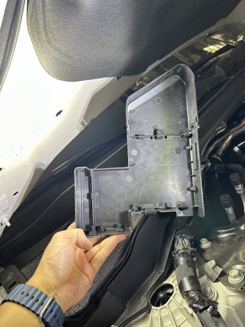

3. The positive terminal tray can also shift, stuffed some foam underneath.
4. Positive terminal tray cover, any and all contact points were lined with felt.
5. Cowl cover that contacts the metal were lined with felt on the passenger side.

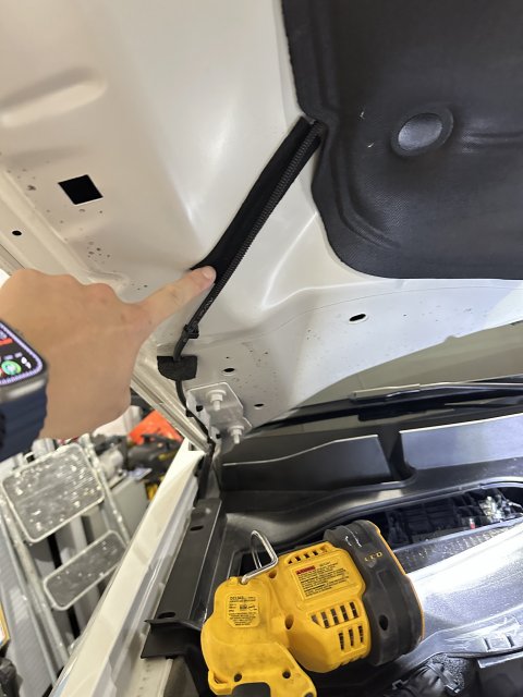

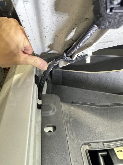

6. Hood release that is lose, contact points were lined with felt.
7. There's some vacuum line connected to the battery left hand side that is fairly lose and can wiggle wrong and wrap around behind the battery. I pulled it up and zipped tied that as well.
