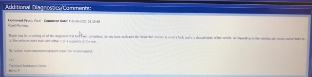

my dealer contacted ford regarding the 1 bolt in my ST and this is the reply he got. WhatsApp Image 2021-12-07 at 10.06.43 AM.jpeg

problem for them is if a catastrophic failure immobilizes a car and kills off a family and kids w/2 dads then it's a PR problem for them, they should replace for anyone who wants it and stop doing it

Thats the argument I'm making... this is a legit safety concern... we should be able to have them swapped under warranty whenever we want.. not just upon failure.
