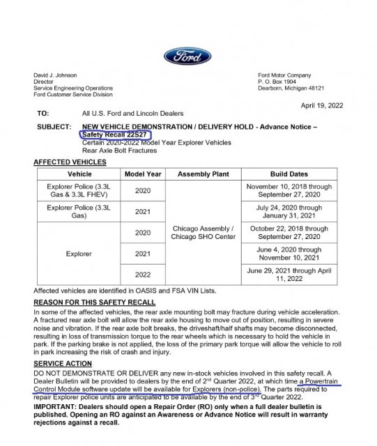

Finally the safety recall notice for single bolt rear ends!!!!!! Yes!!

I guess you mean the e-brake pcm re-calibration?
CareerFiremanGuy
1,083
814
Yup, that's our retail ("non police") pcm reflash for keeping the vehicle from rolling if/when the bolt breaks.

Jesus, so another band aide until it breaks. Doesn’t sound like a suitable solution for safety standards.

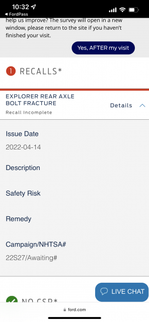

Update- Received a call from my dealer after having the car for a week, saying they want me to bring it back. I picked it up on 4/23/22 the day it was delivered from the factory. I only noticed the recall when I connected the Fordpass app that evening. Called them the next day to ask if I need to stop driving it or bring it back. They said no, a week later they are very eager to have me bring it back and gave me a loaner if I did. I guess that date of 4/19/22 really is legit, and they were, or are looking at a big fine.

Update- Received a call from my dealer after having the car for a week, saying they want me to bring it back ...
WHOOPS!

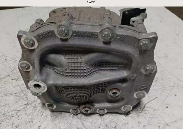

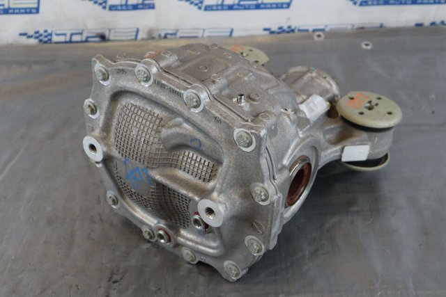

Just an fyi for those considering replacing the cross member. I got quoted $1300 for 8hrs book time labor only as I am providing parts ($1400 for parts). Was considering having Ford do it in the event they eventually up the recall to include the cross member and I might have a chance of getting it paid for. I guessed a grand to do it. Now I just have to decide if $1300 is worth a day of my time and some hacked up hands :D
It looks like you will need a new differential cover also. I haven't found part numbers but here are a couple pictutes.
