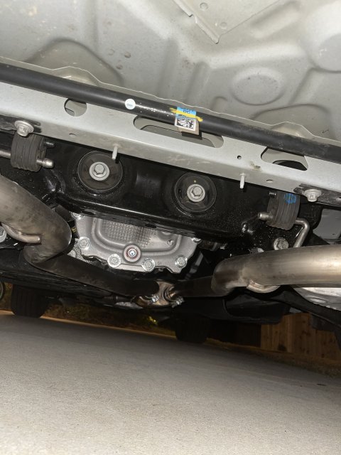

so Im confuse, my rear end looks like its got lots of bolts, does this mean its safe for mods, but the subframe will break and kill me and others?

You are missing the #2 bolt in the subframe. Same as me.

Yup. It is the 2.3L subframe for 2020. Sounds like a number of 2021 ST's were assembled with them. I'd be curious if 3.0L platinums, king ranches and aviators suffer from this tragic substitution.

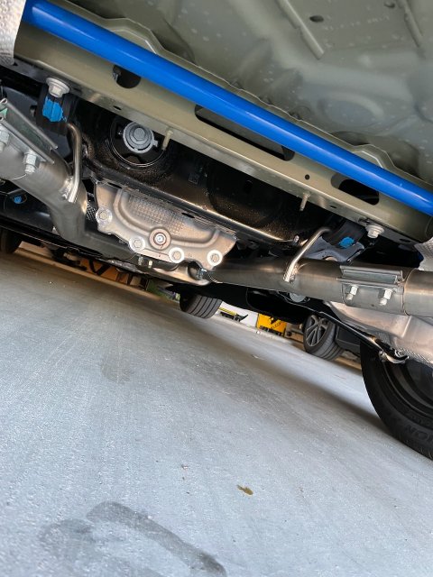

Should look like this

Ive been digging for HOURS, does anybody know what the (missing) bolt PN is???

It's not a missing bolt...the entire subframe needs to be swapped out.

Just looking at the picture you see a hole and think "hey, I can just put a bot in there". It isn't that simple it needs the bushing as you see on the opposite side and that requires the sub-frame (the whole black) X-member to be replaced at over 1K. Some have suggested they might try to put a bushing in this sub-frame. I don't think that's something the average backyard guy will be successful doing.

I understand that, can find the sub frame but not the bolt PN, new sub frame (with both bushings) will do no good without another bolt!

Just doing my research to throw at the dealer! Luckily, I have a good salesman that is helping me with this issue
