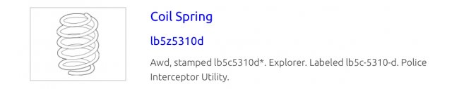

As an update to my second comment above, had a moment to look up my spring codes. They are easy to find on the tags hanging from the springs, or you can see them on the lower right of your VIN label. Mine are ‘DDTT’ - with the front being D’s and the rears T (confirmed by also looking at the tags):
Confirmed the corresponding engineering numbers on Tasca’s site under my ‘20 ST (and also checked another site where it shows the PIU parts) and they come up the same for both versions. The actual part numbers are always different than the engineering numbers, as an FYI.
Other than the allegedly stiffer struts/shocks and the larger F/R sway bars, I’m going with those being the only suspension differences. Of course there may be some bushings that are stiffer as Ford has done in the past with PD vehicles, but there’s a lot of commonality now.

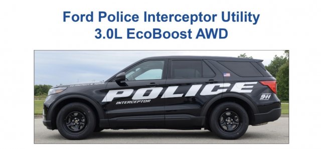

If it matters at all, this PIU photo from the Michigan State Police vehicle test shows a ride height that I would say looks the same as my ST ( with wheels/tires being the difference).

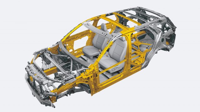

Totally forgot about the full-size spare being part of the rear crash rating. I think the 5G Explorer wasn’t beefed up as much, but here’s a better image of the 6G PIU frame where I think everything yellow is an upgrade to the frame (with the X-brace being obvious). If you can live without the creature comforts, a 3.0 TT PIU Explorer would be a decent daily driver!
I believe that x brace is bolt in…the rear bolts in where the 3rd row seat back bolts in. I was looking at it a while back since I’m thinking about deleting my 3rd row for the next audio build. The PIU interior panels would save me a lot of work as well.
It is a bolt-in brace - attaches at the third row mounting points. It was a relatively easy mod in my ‘14, other than removing the side panels. I was fortunate to get everything from a wrecked PIU for about $500, but I’m guessing all the parts will run a couple thousand easily. Considering some of the additional frame structure on the 6G models, it might not even work as an after thought. Fortunately, there is decent under-floor storage in the non-PIU models, which the previous generation sorely lacked.
