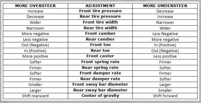

I’ve said it more than once (probably): for an IRS, if you want to take out any under-steer, a bigger rear bar is all you need, with stiffer shocks and springs out back as well. The front bar is a waste of money. Here’s a chart that will help.
