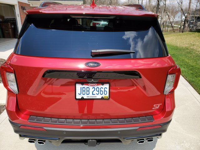

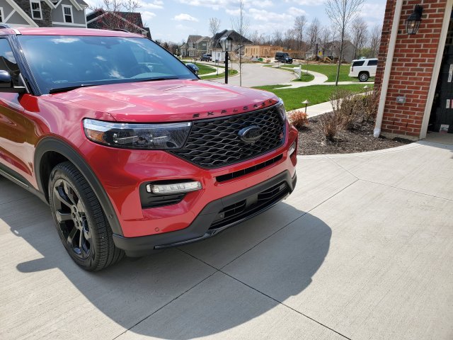

Thanks to EG7047 for the help! Got them put on today, wasn't difficult to remove the front bumper at all, had it off and back on within an hour. Back emblem was easy peasy. I went with gloss black with the Ford script and outline of the badge in matte black.
