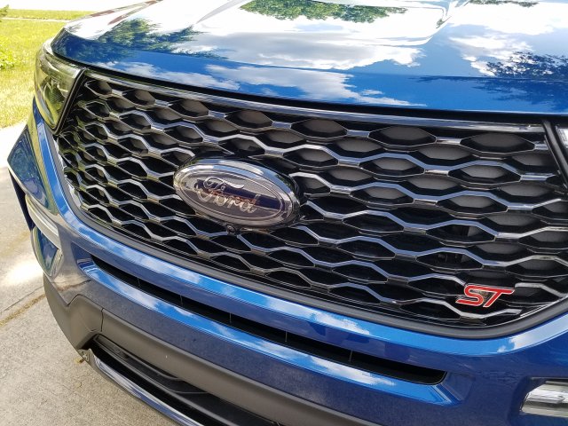

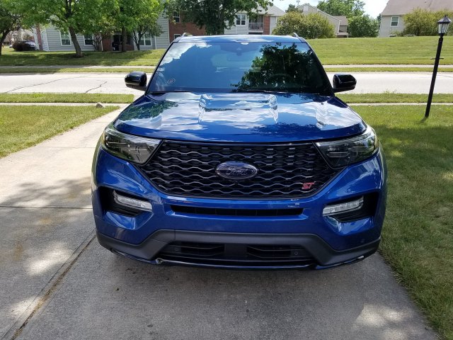

30% window tint on our front badge. Kind of looks like black chrome now.
Also left off the letters after clear film on the hood.

I’m going to tint my car this week so I’ll definitely ask them to place some scrap pieces on there a tad darker

Yeah, we tried a darker piece, too, but then it was too dark. Hard to see the badge, and yet not fully blacked-out, so we went back to the 30-35% tint. Couple of weeks now and I'm still satisfied.

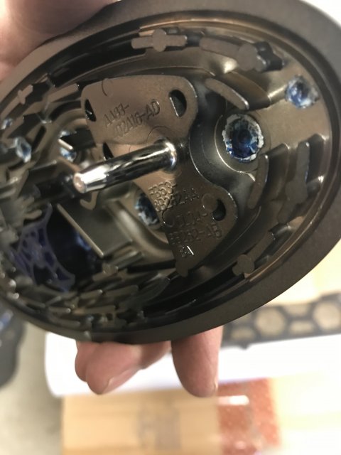

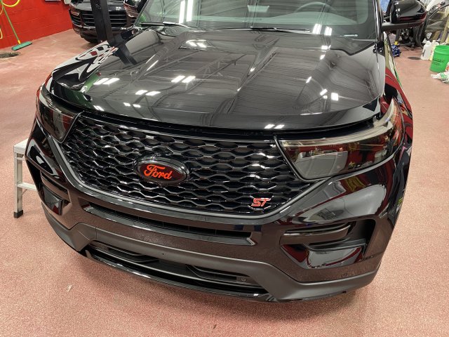

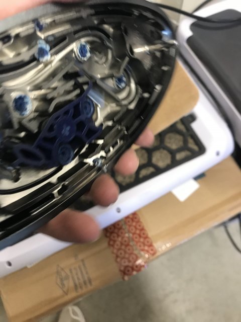

Finally had these emblems installed. I think they look great! View attachment 280 View attachment 281
Looks great! Did you get the badges from OEM Autoart? I got some all blacks from them this week and I went to do the swap and there is no way to attach the new front badge

Did you by chance notice if there is anything from the back holding the ST emblem on? Im getting one made blacked out and of course I had my bumper off and was too into that Ford emblems process to notice at the time lol
The front ST badge is taped on nothing else you can peel it off.

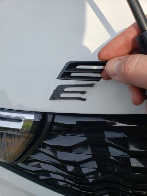

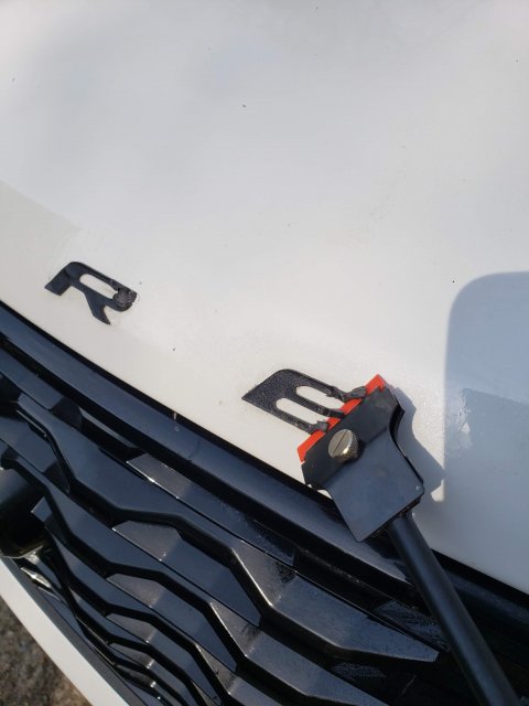

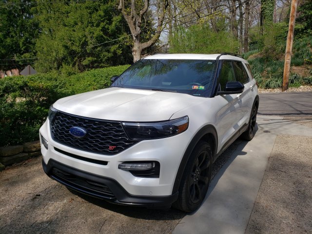

DIY Debadge
I've never done this before, so thanks to the pros on here who talked about it. In the end, I felt taking the EXPLORER letters off would leave a cleaner front end, especially on the bright Star White model I have. The Black letter/white contrast really made them stand out. The triangle between the letters, the Ford oval, and the ST never looked great to me; graphically, it's imbalanced and it bothered me. Taking the oval out wasn't an option with this grill and I like the ST, so the letters had to go. Plus, cleaning bugs around the letters was annoying and on rainy days, I'd get dirt streaks up the hood from the aerodynamics of the letters. So I went for it.
I bought some adhesive remover, a scraper with a plastic razor (plus a few extras...which I didn't need), and had a microfiber towel on hand to buff it all off. Probably 15mins of work, and it would have been less if I'd let the adhesive remover soak a bit longer. It took a few passes of popping off the letters first, then the foam backing, then the remaining adhesive. As a word of caution: I tried to be really careful with the metal backing of the scraper, but I think I might have nicked the paint just a bit on one or two letters. Either find a whole plastic scraper or maybe tape up the backside of the tool. bummed about it, but have a touch up plan with the dealer for chips and rims. a few more front end stone chips and I'll bring it by for that. nothing too deep.
Feedback welcome and happy to hear push-back on if I should have kept them on. If the votes are thumbs down, I could always learn how to reapply them or get the cooler Interceptor badging.
cheers from Pittsburgh, land of dirty roads, bugs, and tree sap. 1.jpg 2.jpg

did you heat them up at all?
Kirk ST
120
Pittsburgh, PA, USA
I did not. The adhesive remover just said to apply it between temps of ~50-85f, and we had a nice sunny day in the 70s here. I had it parked in the sun for a bit, but no other heat applied.
