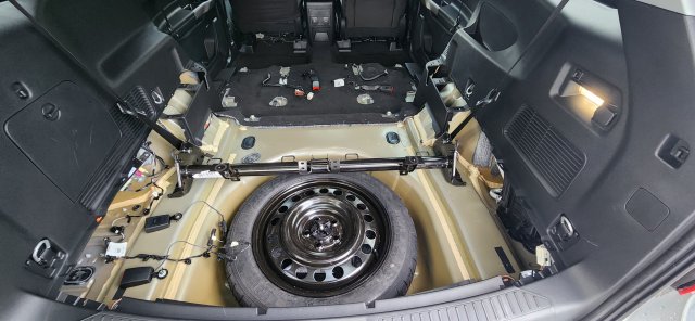

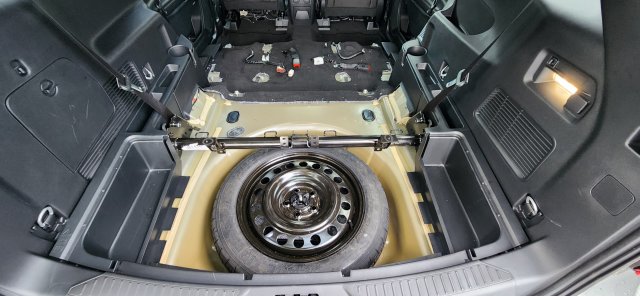

Here's what worked for my 2024 Explorer to:
-avoid purchasing an interceptor cross member \ 3rd row brace
-avoid the dreaded airbag & rear belt monitor fault lights
1) Unscrew all the seatbelt receivers from the seats WITHOUT un-plugging any of the wires from any of them. The wire has a lot of clips under the seat which will require patience to delicately remove each clip and the receiver can be pulled completely out of the seat intact. Then can just pull the whole seat out, leaving the intact wire\receiver on the floor. The wiring looks very fragile, so just take your time, testing after each removal by turning on the car, check for warning lights to confirm didn't damage one of the wires.
2) Remove the cushions from the 3rd row seat cross bar and just reinstall the same cross bar. I cannot think of any reasons that removing the seat cushion from the bar would lower the safety of the cross bar but would definitely like input from anyone if I'm overlooking something.
Updated pics.
I pulled the 2nd row seat belt receivers\wiring underneath the carpet to store them safely underneath the two front seats.
Thanks Franz and others here for your inputs! This seems to be one of the only threads on removing these seats.
