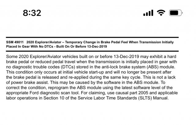

Ooook, so yes this issue is real, and can’t believe Ford hasn’t addressed it in the form of a recall. I have heard of more than a few people complain of this Happening on this forum. It was first brought to my attention by my wife, who primarily drives our 2020 Platinum. I have experienced to the extent of it just moving backward maybe an inch or two, with my foot firmly on the brake. On one occasion my wife claims she almost backed over a co worker who was standing a good ways back behind the truck. Freaked my wife out pretty good, said she had to let off the brake pedal completely and then stand on the pedal to get it to stop.
As a Ford Tech, I did come upon this special service message that seems to have cured the issue on my vehicle. I also performed it on a ST at my dealership when a salesman complained on the same thing happening, the ABS module needs to be reflashed, there is also a software update for the gearshift module that I would also recommend doing.
OMG - thank you so much! Exactly. Have to lift foot and then stomp on the brake to stop. I’ll be sure to have them follow your bulletin. I have another related and or unrelated issue of a hard click and lurch when going from P to R they’re addressing. They thought this was part of that as well. I’ll show this to them and have these flashed as well. Tysm!
I just bought a 2020 platinum and the wife (primary driver) has tried to explain an odd and intermittent braking issue that sounds like this. Any updates after bringing up this bulletin?

Giving a quick update to my above question. I have access to FDRS and can update modules myself so I updated my ABS module per the above SSM 49011. So far so good after 2 days or so with no rolling back. I will keep my eye on it to see if it is really fixed.

I'm intermittently experiencing the same issue when shifting from P to R - vehicle has been on slight incline (my driveway) to completely flat parking lots. I always let the vehicle warm up prior to putting it in gear - there are no warning lights on the dash when it happens and the only way to get the vehicle to stop is to release the brake pedal completely and then press hard to stop the rolling vehicle. I've had two near collisions - it's been to the dealer and they reflashed the ABS module and it stopped for a couple of months but now it's back again.

Hey I know this is a bit of a dead thread, but I purchased a used explorer st a few months ago and this happened to me a few times. This morning the car rolled back 2ft, engaged the brakes and released them then did it again 2 more times. It moved probably 6ft total. Fortunately I found this thread and will take it in tomorrow with the tsb for them to reference. I find it so strange the previous owners wouldn't have dealt with this.
