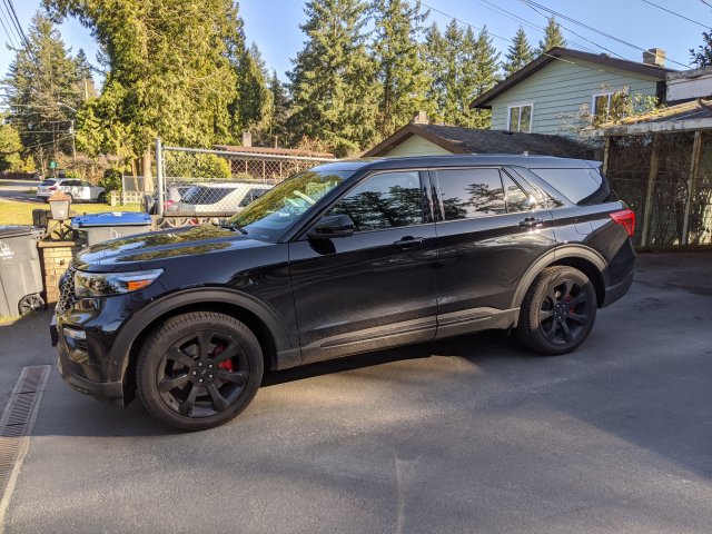

So I found out if you want to remove the roof rack you have to drop the inside headliner to get to the six nuts that hold it attached to the roof. Unbelievable
S
Surrey, BC, Canada
Thread Starter #10
Was it a pain in the ass?
Not too bad, About two hours... Very carefully dropped each side of the inside headliner to get to the nuts that secure the rack to the roof. Patience is a must not to damage the liner... Make sure you have the right tools...

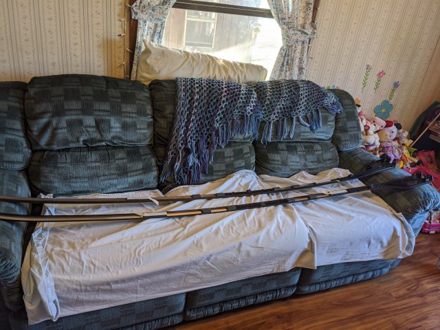

Factory Insert Part #'s:
Part Number Part Name Price
LB5Z-7850462-AARoof Molding
LB5Z-7850463-AARoof Molding
$207.21 ea
Source: Levittown Ford Commercial Parts Sales ............ Benny is the contact. IMG_20200517_184450.jpg IMG_20200517_184407.jpg
Grand kids play room ............. Can you tell ? :rolleyes: These will be installed tomorrow at the N TX LEA skunk works.
