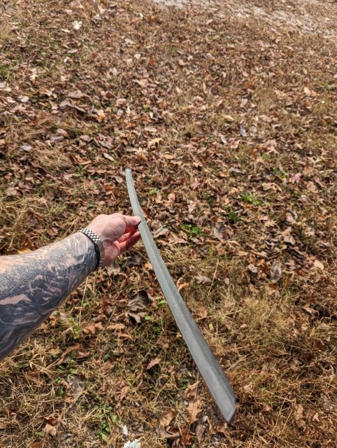

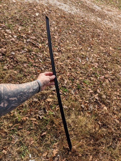

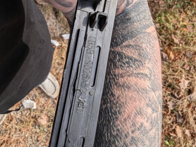

So I ordered these exact parts and they came in today. The "retainers" look like this. Is this correct? I don't see anywhere where these would attach PXL_20221111_195427905.jpg PXL_20221111_195424908.jpg
4,569
5,343
travish325
48
KY
Dunno what those are but they ain’t it. lol

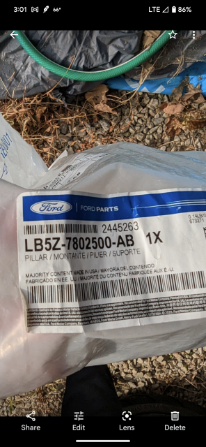

Here's a pic of the what the packaging says
The back of the part that was in the packaging says this number: PXL_20221111_195435582.jpg
298
219
2022 Ford Explorer Platinum
So I ordered these exact parts and they came in today. The "retainers" look like this. Is this correct? I don't see anywhere where these would attach View attachment 15100 View attachment 15101
:oops: well that's embarrassing! I'm sorry for providing bad information. That's what the dealer ordered for mine. Still waiting for some other back ordered parts before they'll do mine. Sorry man! I'll make it right for you.
