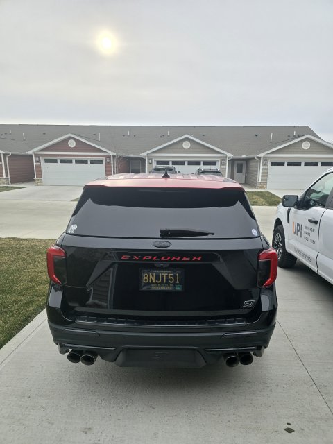

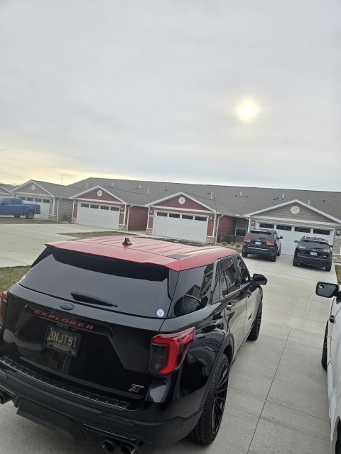

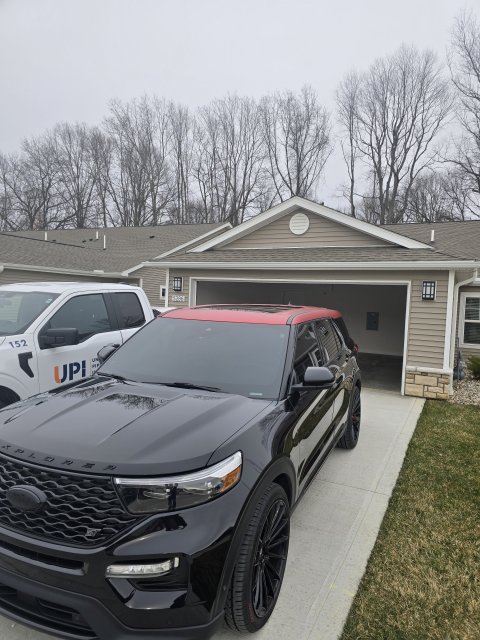

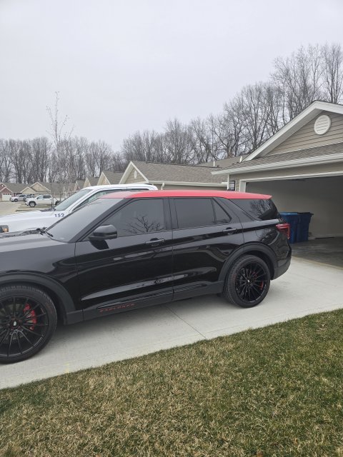

I know this is a old thread but wanted to put some pictures on of my rack delete and wrap
200
San Rafael, CA
#32
Car looks good! But kudos on such a clean garage! I would have to board up the door from my house to the garage to have a garage like that! As soon as my wife knows there is an empty room somewhere she fills it! Lol

#33
Car looks good! But kudos on such a clean garage! I would have to board up the door from my house to the garage to have a garage like that! As soon as my wife knows there is an empty room somewhere she fills it! I am single with grown kids.

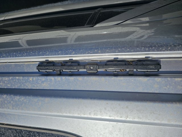

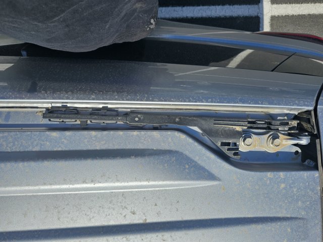

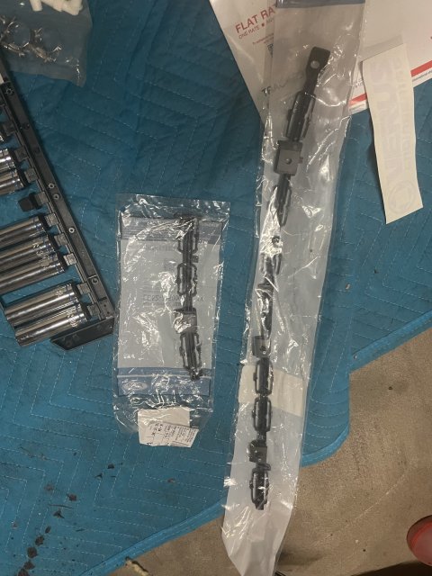

Unless Ford changed something…those are just part of the car under the trim. It’s been too long and I don’t remember but I was the 2nd or 3rd person to do this mod and the parts list is 4 part numbers. 2 front retainers and 2 trim pieces that run front to rear. Those 4 parts are all it takes to delete the rails.
Are the retainer clips 2 different lengths? This is what I was sent, just wondering if it’s right before I tear everything apart..
