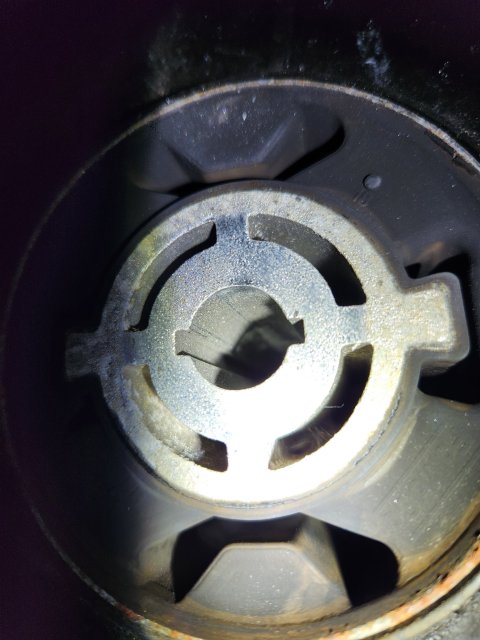

Just got back from dealer for another follow-up. The bushing around the bolt to the rear subframe broke allowing flex and clank noise when shifting between D and R. New subframe ordered. Deemed not safe to drive. Parts diagram for replacement subframe shows two bolts. Hoping for correct part. I'm in a MKZ loaner.
My takeaway, if you are hearing a clank noise when shifting between R and D, etc. Get it checked. They put it on a lift and said it was flexing "a lot".
Of note, mine starting this noise around 21k.
Update:
Here is pic of the cracked bushing
Lower right

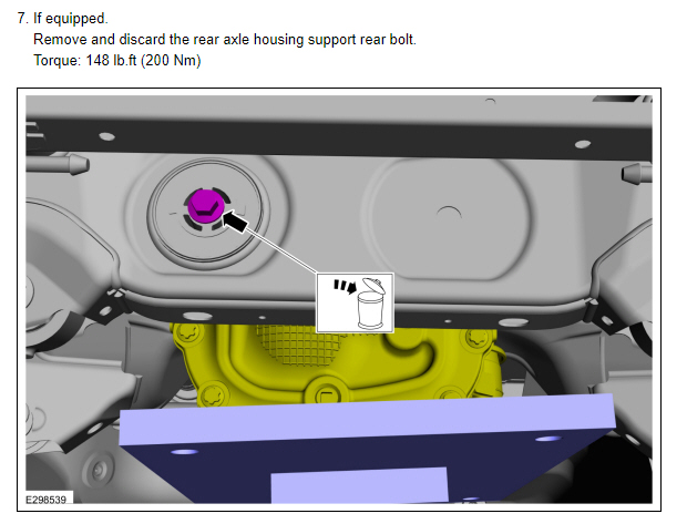

I am confused. Are the mounts either 1 bolt or 2 on the rear end? Don't the 4 bolts that are on the bottom only hold the casing together?
Been following this subject, but there seems to be a lot of confusion between here and the FaceBook page.
1,502
There are two vertical mounts at the front of the differential (toward driver) There are either 1 or 2 horizontal mounts at the REAR of the differential as pictured below. There are literally several thousand posts on here about it. Look up the thread Rear End Damage.

Here is a photo of the rear diff with two bolt holes for mounting to the rear subframe
