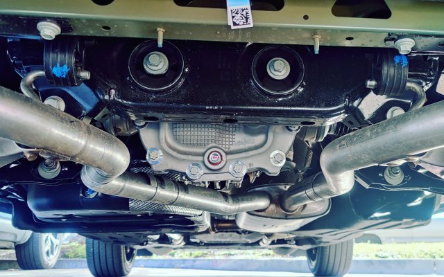

Here is a photo of the rear diff with two bolt holes for mounting to the rear subframe
My 22 also came with a two bolt diff cover and a one bolt crossmember. I opted to replace the crossmember and add the bolt. Piece of mind for me.

My 2021 came with the 1-bolt rear support as well, so I bought the better 2-bolt subframe that’s still in my shed. I also bought the AWR support bracket as I think it will provide plenty of support. I’m thinking of selling the new subframe now…
