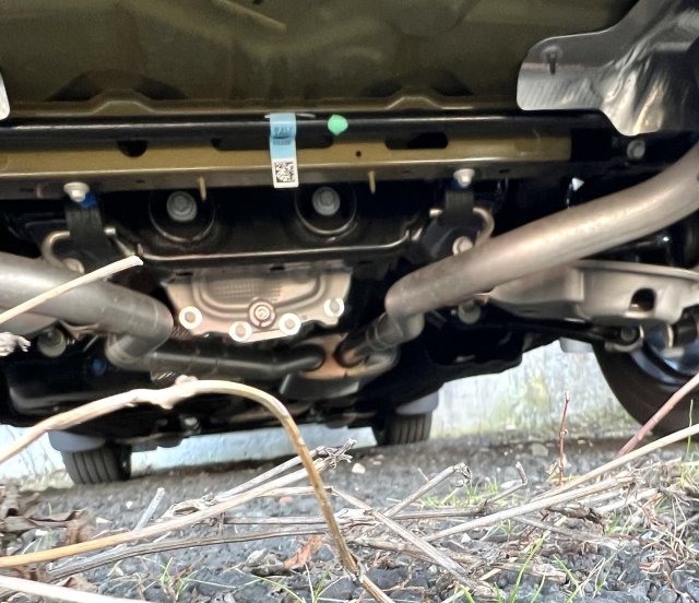

Just catching up...
I will say that my bolt didn't break, but the bushing around the bolt broke.
The symptom was a clicking noise when the driveline flexed (park/neutral/reverse).

First time I've heard of the bushing breaking. Did your dealer replace the sub frame to repair it?
125
51
Va
Yes, I posted that info and pictures on another thread

Was your subframe replaced with the 4 bolt or the same 3 bolt?
125
51
Va
Ford would only cover the same unit.
Old vs new shown. See the one mount point on subframe.

They replace the entire rear subframe for a failed bushing? Or was there more damaged.
Personally, I'd get rid of the car! Ford says they will only fix it once. Happens again and you might be on the hook for thousands of dollars if it takes out your driveshaft, axles, and rear diff. I'd inquire whether this failed bushing counts the same as a failed bolt--one fix and you're done.
