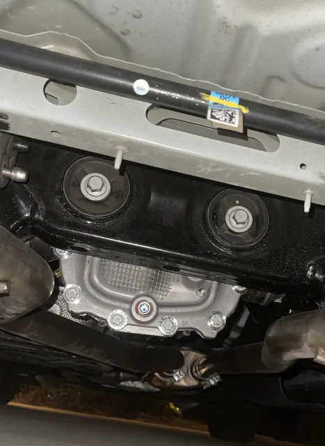

Anyone have a photo of what I should be looking at? just to see if i have it or not. What do I look for when it starts becoming a problem?

3 Bolt rear
4 Bolt rear

if you have the 3 bolt frame, unless you pull the bolt out periodically to see if it is bent, you’re not going to know if it’s a problem as it would be tough to see any change. If you’re lucky and have a 4 bolt frame, it shouldn’t be an issue.

I think I have seen people say that the rubber bushing around the bolt will be pushed in if it’s starting to fail. Take that with a grain of salt though.
