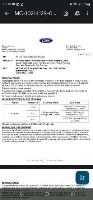

I feared this would be the response...
After 10 months of arguing and bickering with Ford NL and the dealer they finally admit there are issues with these cars, this being one of them.
As a final attempt to fix my issues they want to perform the 22N06 recall (which has been put out only last week or so for NL).
I fear it'll only be a very temporary fix at best if they don't change the subframe alltogether.

Yes the only real fix would be the 4 bolt subframe. Ford will never go that route though as it's very costly and most people will never have this problem as they drive moderately

What is the 22N06 recall?
