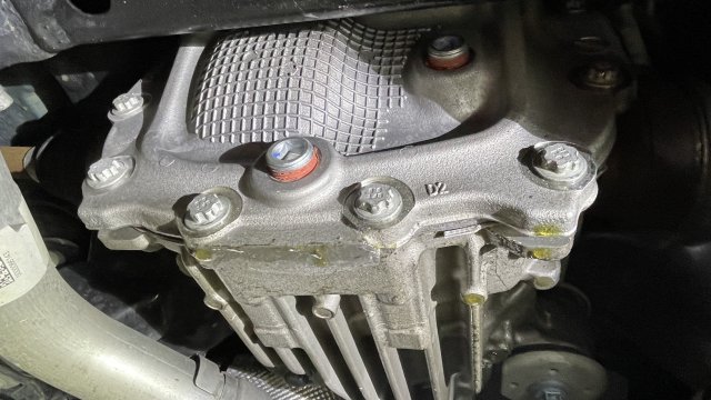

Had the recall done a few weeks ago. Took the ST on a road trip this Friday. Got it back home and found this along with a puddle of fluid under the vehicle in the morning.
Going back in to have them correct it on Monday. Sigh….

That sucks. Nothing like waking up to a puddle of fluid under your car. Hopefully they get it right this time.

Got word back from the dealer that the gasket on the differential failed. Asked if they had needed to remove or replace the differential cover during the recall and was told no. So they’re at a loss for why it failed but that it did. I think that cover had been removed and the technician either left the old gasket in place or replaced it but in either case didn’t torque the bolts to spec and they’re just not owning up to it. I’ll get the vehicle back in a couple of days and the first thing after checking for any weeps will be to check the bolts to make sure they are at the proper torque.

Thats odd. I have my old differential cover in the trunk, because the had to replace it when doing the recall!

If I remember reading the procedure correctly, they’re supposed to inspect the cover/bolt hole area and replace cover if damaged at all.
