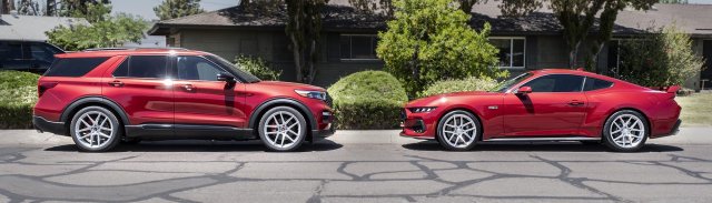

Same-model wheels on ST and Mustang GT Premium
56
79
Phoenix, AZ USA
'23 Expl. ST and '24 'Stang GT Prem., Rapid Red
I LOVE 'em!
71
Southern New Jersey
Gotta love the fact the Mustang has the Same Center Bore size also.. No Hub Rings needed....

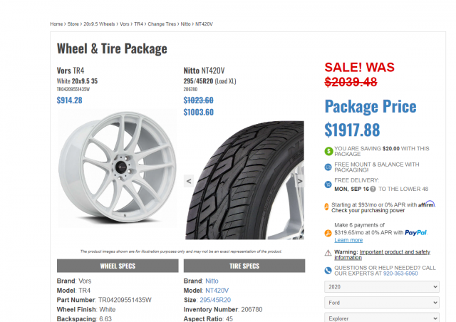

I'm kind of into the meatier tires. What size are you running on the 20s? I think I want to do white wheels and they're hard to find, but i found 20x9.5.
Usually 285/50/20 are the norm for 20x9.5. I went bold and tried 295/45/20 and they work just make sure you have more than +20mm offset wheels or you may rub the fender if lowered. FTL on my part.. lol
I am running 275/50/20 on my 20x9 Voxx Wheels
