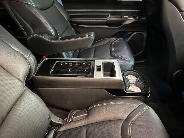

When you get tired of that step up to the Aviator console. 0D7421F6-51B9-48A1-8DEA-E1E4610D5482.jpeg

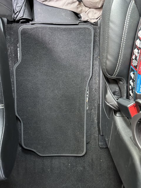

Thanks for this post!!! I interested adding the cup holder as I got the all weather floor mats and ford hasn’t updated the floor mat for captain chairs without cup holder on the floor so I have a large area of exposed carpet between my floor mats.

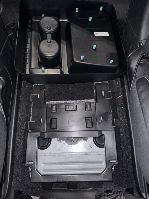

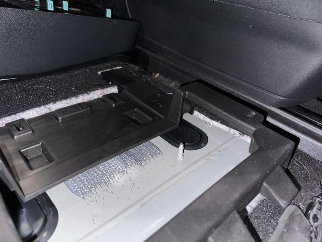

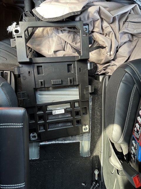

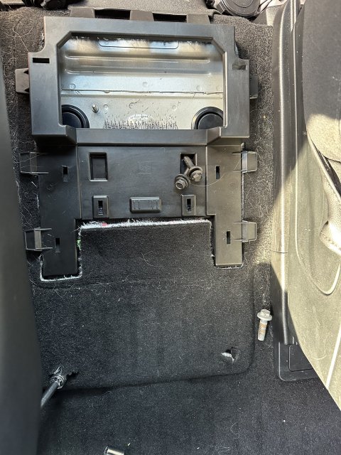

Hello everyone, my wife and I recently received our 2022 explorer that we have waited about 9 months, upon receiving our explorer we noticed the second row doesn't have the cupholder insert in between the captains chairs. However they did give us fold cupholders behind the front center console. I am a technician at Lithia Ford in Boise, IDAHO and from my experience those cupholder like to break. We really enjoyed our center cupholder between the captains chairs in our 2020 explorer ST. In my experience I have found that Ford often times with discontinue certain features or trim pieces and still leave holes and this is no different. I order the bracket, mounting bolts and cupholder tray from a 2020 explorer St. I then removed both second row seats and to my amazement found that the holes are still in the floor, you have to cut your carpet to fit the bracket but after that its a breeze we also burned the carpet that we cut to keep from fraying, total install time was around an hour and a half for me and the best part was I just used my ford pass points to pay for it. below I have included pictures. View attachment 13153 View attachment 13154 View attachment 13155 View attachment 13156

Hey all, my wife is looking at getting a 2020 ST to replace her car that was totaled a couple of weeks ago. I'm curious if anyone has done this swap in reverse. We want our pup to be able to lay down between the two middle seats but the cupholder is in the way of that. If we were to remove it, how large of a hole in the carpet would I need to try and cover up?
I installed one on my 23 ST, the opening in the carpet has to be larger than the mounting bracket but smaller than the cup holder or the cup holder will not lock down completely and rattle, hope this helps. See the picture in Post #1.

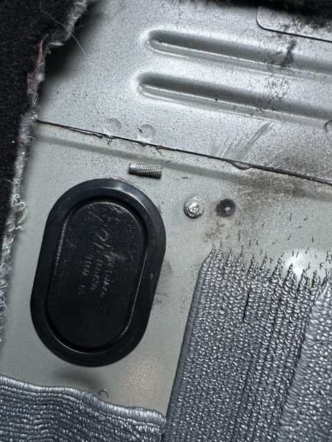

Removing the console from my 2020 Ford Explorer ST. The console just pulls out directly up with some force (the clips seemed to not break either).
I did notice there are screw threads on a bolt sticking up. I will definitely have to cut this to put a flat carpet over it. Does anyone know what this is to?
(Removing console for my dog to lay there on road trip). IMG_6809.jpeg IMG_6808.jpeg

#36
I'm guessing it's just to secure the bottom plate under the plastic console covers. Cutting em partly should be fine

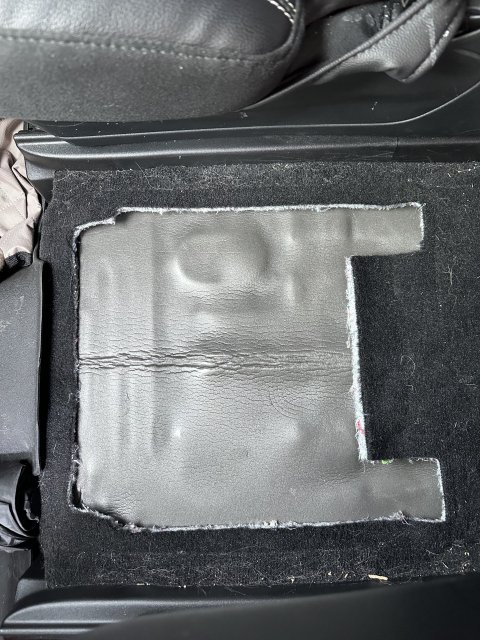

#37
1. 4 bolts (5/8th and 1/2). I had to cut X’s with box cutter at their locations in the rear.
2. Cut the bolt sticking up with a dremel and filed
3. Added adhesive soundproofing
4. Put a floor mat over for temporary fix.
Dog will be happy for a new space to lay down. Thanks for the pictures of the install above!
