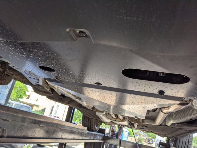

Having already christened these by running over an errant goat at 23:00 hr the other night, I'm
so glad I had them installed. The PB8 wraparounds for the lights are being shipped to the skunk works next week from Setina. IMG_20200514_155256.jpg IMG_20200509_082553.jpg IMG_20200508_095355.jpg

Can you please share how you managed to make your Setina PB400 work in conjunction with all the sensors on the front of the ST?

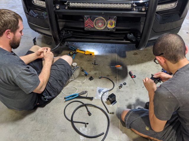

Techs working on the install .......... One mounting bracket on the floor in the foreground. Tech holding the other bracket.
The finished product. The kit is the one Weston makes for GM products. Techs cut/soldered/heat shrink R&L side extension cables to the OE cables. Works like a charm. No CEL, or pop up warnings on the screen. The sensors are not reading the push bumper. The scaring on the top crossbar is from the damn goat I nailed several days ago. Considering he went down and under, I'm damn glad I spent the money on the skid plate from Setna.
View attachment 773 View attachment 774

Did you just move the two sensors?
No other Driver Assistance Sensors affected?
How about the front camera visibility?
I guess I'll have to do some wiring again,if I want my Setina PB400 on the front.. I'll wait till the weather gets better up here in the Great White North.. There is quite a bit of snow on the mountains, still a bit chilli during the day to be playing outside

Just the two inside ones. Front camera view does show the cross bar when in use but the view is still useable. Again, I will try for a screen shot later this am. I am due back at the skunk works for the luggage rail removal and PIU insert replacement next, followed by the PB8 headlight guards when Setina gets off their arse and sends them. ;)

Do you have the model # for the skid plate? I was on there website & never saw it. Thank you.

does the skid plate retain heat? how heavy is it?

Mikey, how's that skid plate holding up? How much coverage does it provide?
Want some extra protection and trying to decide be between the Setina or PIU one. Thanks.

Hello there. Came across your post. In the market for undercarriage protection. Ran over a wooden pallet on the highway. First thing I though of was the plastic oil pan. Would like to know what brand or part number is that on your st. Thanks.

I am guessing the skid plate(s) are the one for the interceptor utility, anyone knows if it is a 'bolt on' for the ST or is there other adjustments that need to be made?
https://setina.com/spec-your-vehicle/
Steel Skid Plate
PART# SK0561ITU20

Jrgoffin, does the plate cover up the downpipes or just the engine/trans? Would definitely love some additional protection but don’t want to raise under hood temps.
No. Engine and tranny.
