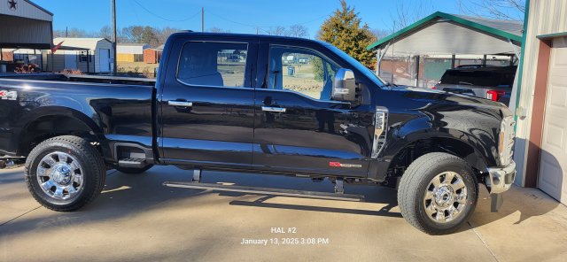

It's almost a hybrid
2kw generator on board
Yes it's the HO engine
It's akso in shop tonight

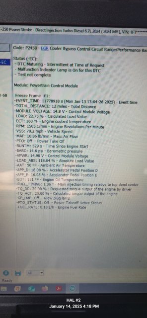

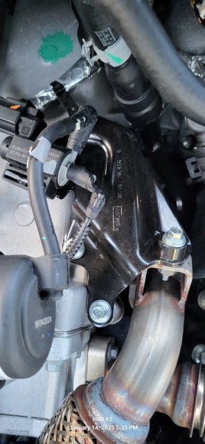

A mouse attacked it at dealer lot and bites must have let go and few hoses
Do now I have an expedition as a loaner

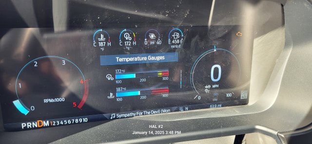

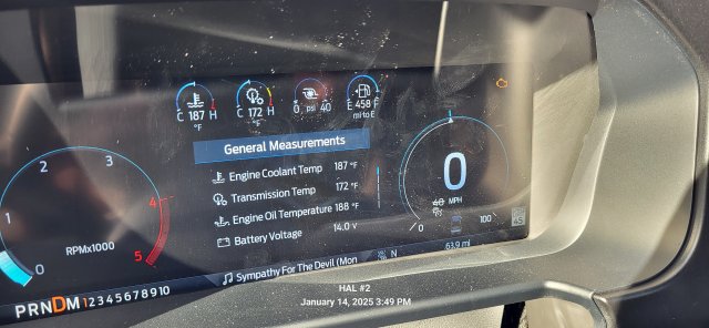

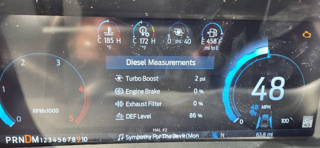

Like tye dash...more information than we ever need
