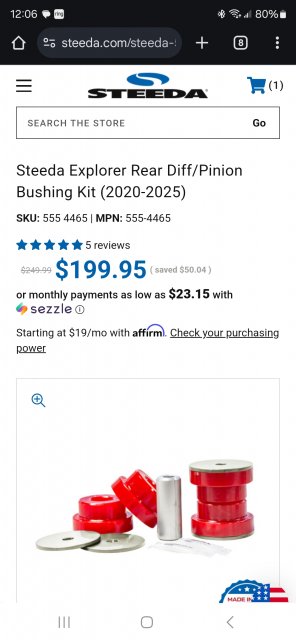

Any thoughts on replacing front bushings at the same time? Thinking of getting steeda kit with pinion bushings. Ty
1,582
768
What front bushings? The diff bushings?
1,582
768
53
Calgary, AB, Canada
After having the rear diff recall done - changing of single diff bolt and bushing in rear carrier, amongst all other bolts they changed, which were many. I added some stuff.
Steeda: Rear Diff Brace, Rear Swaybar End Links, Non-adjustable Toe Links, Rear Diff Pinion Bushing Kit, ST Subframe Bushing Support Kit
FenFab: Vertical Links.
Now everything seem more planted, positive without slop.
And no NVH issue with any of it.
