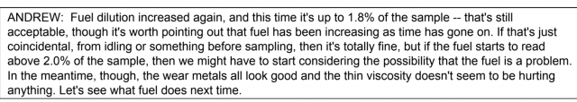

Here is another data point that may or may not have anything to do with this issue, fuel dilution on my engine has been increasing and the viscosity has been thin from the first sample at 1000 miles, this sample was taken around 30k miles.
