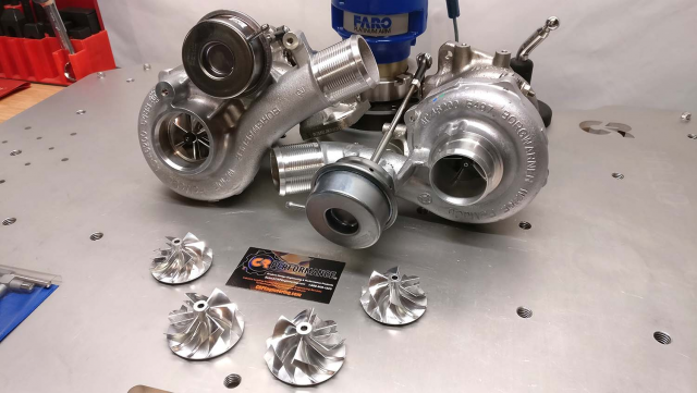

It is really strange that only the drivers side seems to be the cause of this issue. Maybe there is a slight design difference in the driver and pass side turbos that is causing this?
tjrigario
24
OH
I'd guess it has something to do with heat. The part number is the same for both sides (6K682).
1,501
Are you sure that's true? It doesn't seem likely given the pics I've seen which show different compressor castings.
tjrigario
24
OH
Yep - it's the same part number. There are some different tubes, etc. that go on each side, but the turbo itself is the same. The sad part is...it's a freaking $575 part. I just had a $8000 engine put in that didn't fix the issue.
1,501
I don't know where those part numbers are from, but I think they are misprints. Because here are pics of ST turbos. Notice the difference in the compressor housings, the placement of the wastegates, etc. Also, if you zoom in you'll see that the one compressor housing is numbered 5487 while the other is 5488.
tjrigario
24
OH
Interesting. I see what you are saying. They are slightly different. Those numbers are right off the Ford Parts website...but ironically enough one is a couple dollars more than the other.
