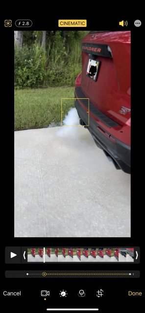

Funny you should say that I left my ST in the garage overnight yesterday and this morning it DID NOT smoke. I don't want to speculate my car has been siting on the driveway last week while I was installing ceiling racks inside my garage, and my driveway has a bit of an incline. Someone else on these posts mentioned smoking only when on an incline, i'd hate to think parking incline would be a concern but more testing. Im still scheduled to drop my car off for sunday night

2022 with a cold start bellow of smoke issue. Driveway is an incline but that doesn’t seem to matter. Will be videoing cold starts every morning to see how consistent it is.
