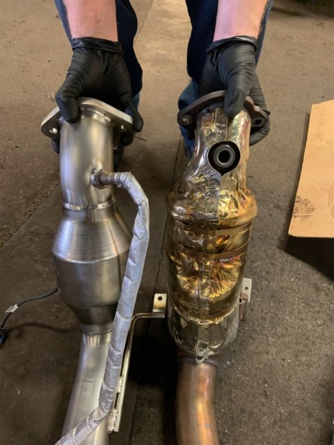

Has anyone installed yet? Anyone having issues with the O2 sensor hole in a different position - hitting the engine block when installing? 1F8EB9B5-DF59-407B-A413-DF9DC7BD0DA4.jpeg

Me either...definitely paying attention now though.

Ya not sure what the difference is....but I’ll keep you all posted. My installer’s been on the phone with SPD so we’ll see.

This is not good news.... Thanks for the heads up

I sent lethal performance an email to give them a heads up. Before they send mine out.

I definitely see no reason at all to relocate the bung.

UPDATE: the alignment was off on the O2 sensor hole when machining the left pipe. Sounds like a one off issue but better heads up than surprises. Good news is, Jacob at SPD was awesome to work with and super responsive - a replacement pipe has already been shipped overnight so should see it as fast as Canadian customs can clear it!
had my tech talk directly to Jacob - could have also had a local machine shop relocate the hole but I felt I’d rather have the fit and finish of a new correct pipe.
not pleased it happened but SPD made it right and quickly, so all good!
